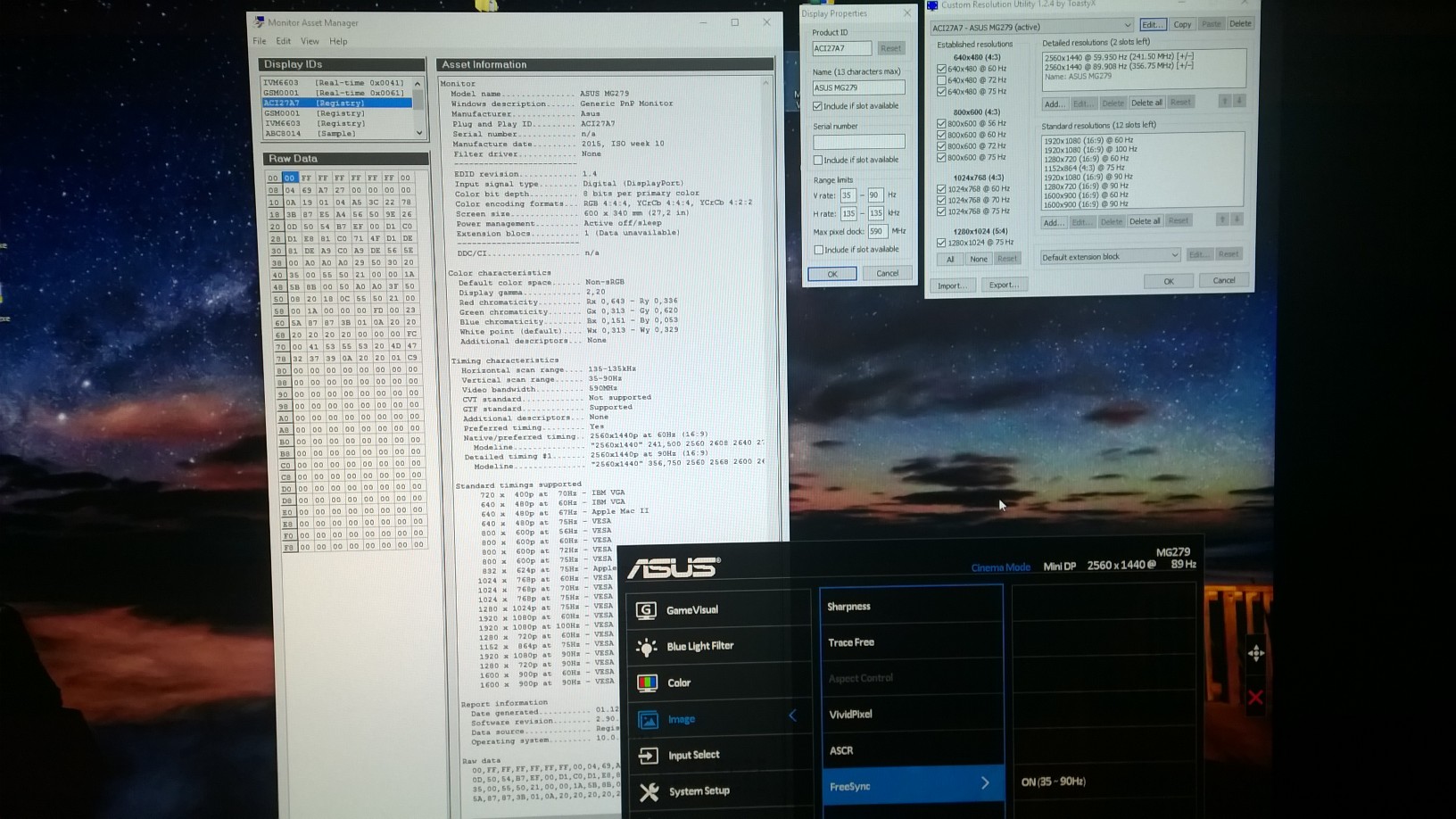

hey guys, i tried to alter the freesync range from my asus mg279q, but i think i have done a mistake... i want to reset all the original settings to my monitor, but i dont have a clue how this will work. The version from the first page seems not to work (or im just to dumb Sad )
If freesync is on, you can see on picture 1 that the horizontal scan range ist 135-135kHz, vertical scan range is 35-90Hz and video bandwith is 590Mhz, I think that are the default settings.

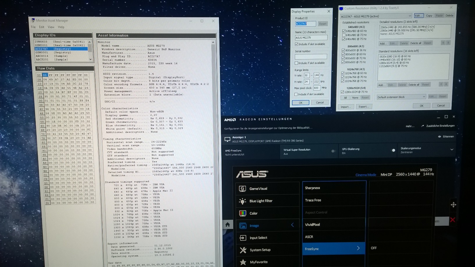

If freesync is off, the values are 24-222kHz, 50-144Hz and 600Mhz. I dont think that are the default settings, or am i wrong? (picture 2)

(12-01-2015 10:51 PM)rutatsat Wrote:  If freesync is on, you can see on picture 1 that the horizontal scan range ist 135-135kHz, vertical scan range is 35-90Hz and video bandwith is 590Mhz, I think that are the default settings.
The monitor seems to be switching EDIDs when you toggle FreeSync. I don't see any overrides in your pictures, so those should be the default settings.
