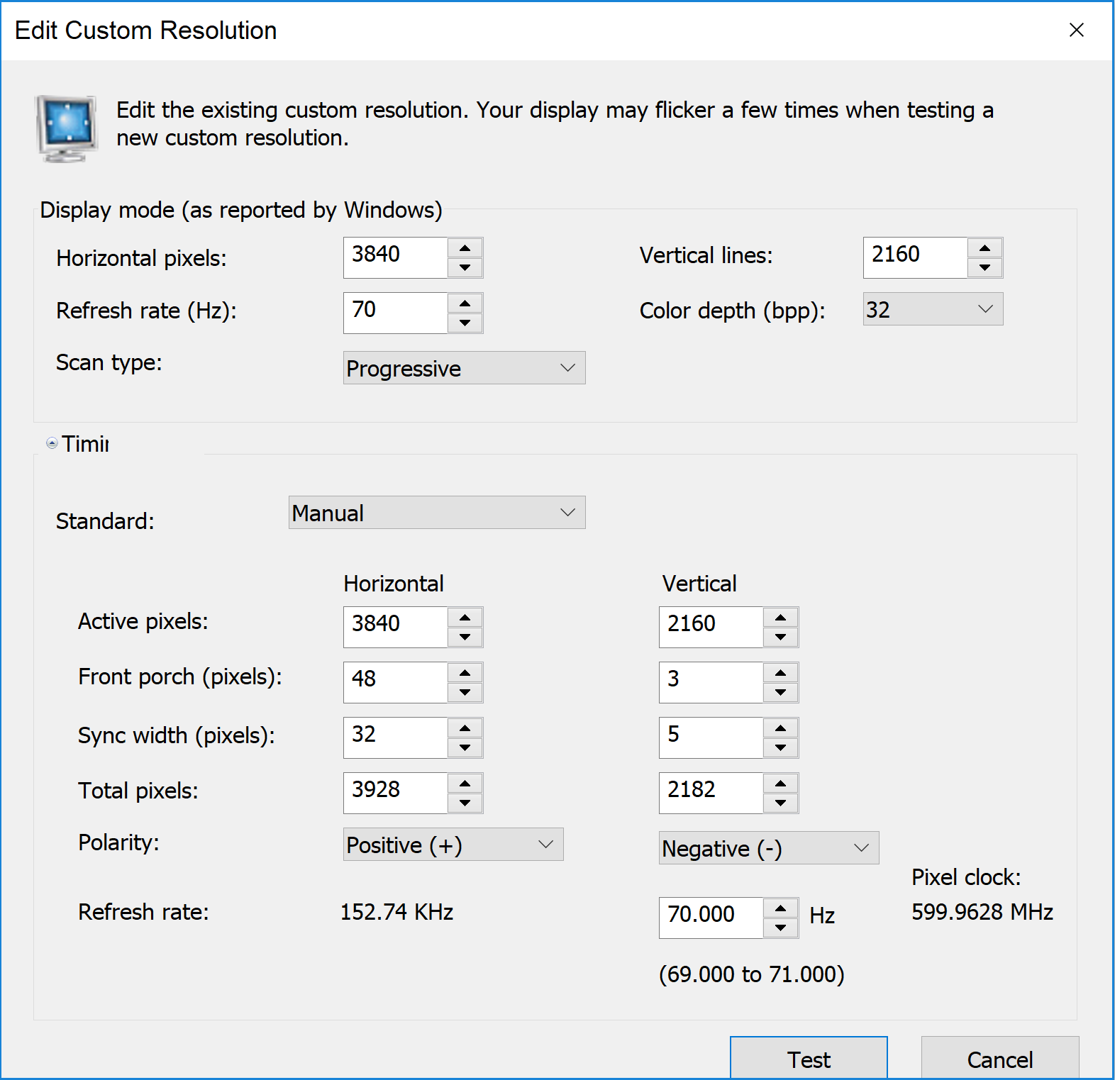

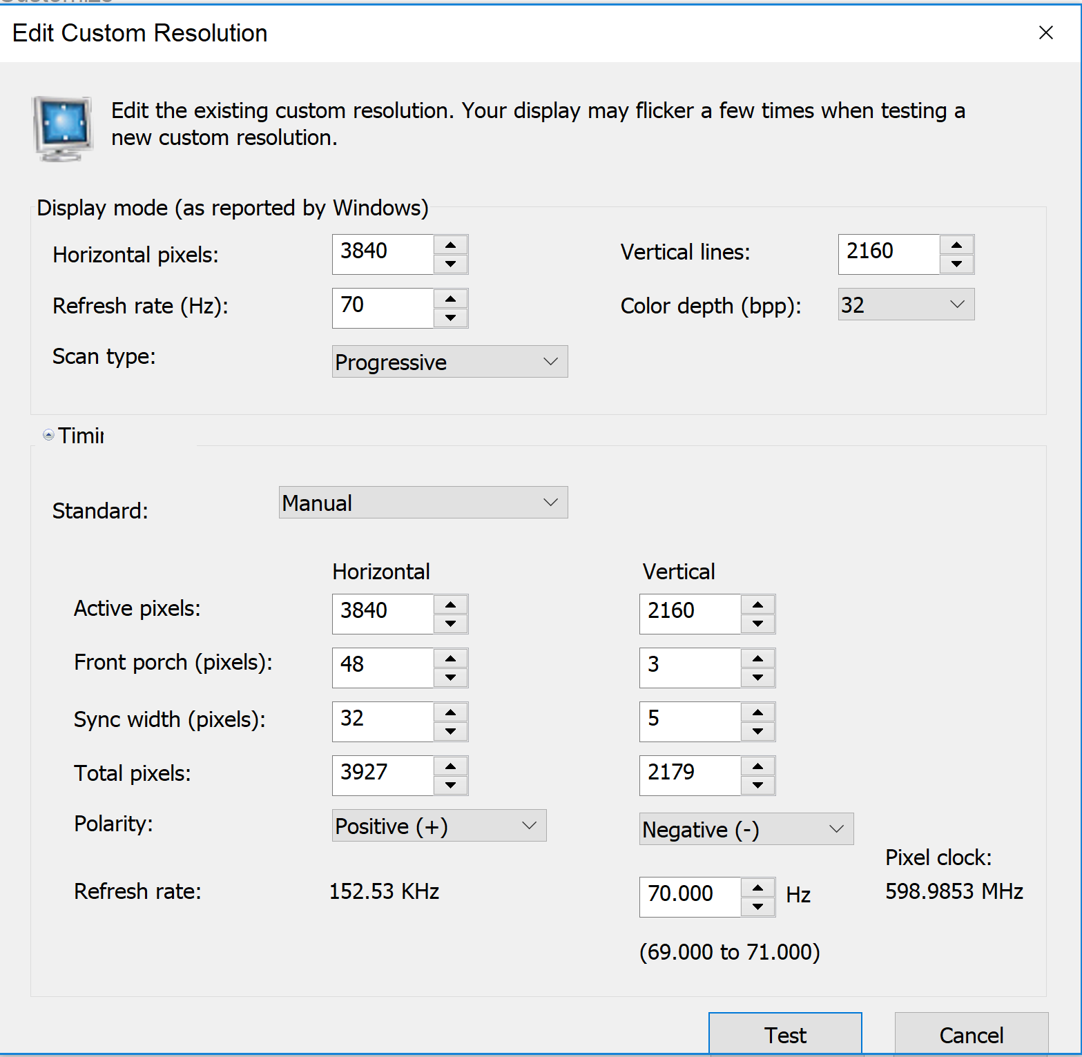

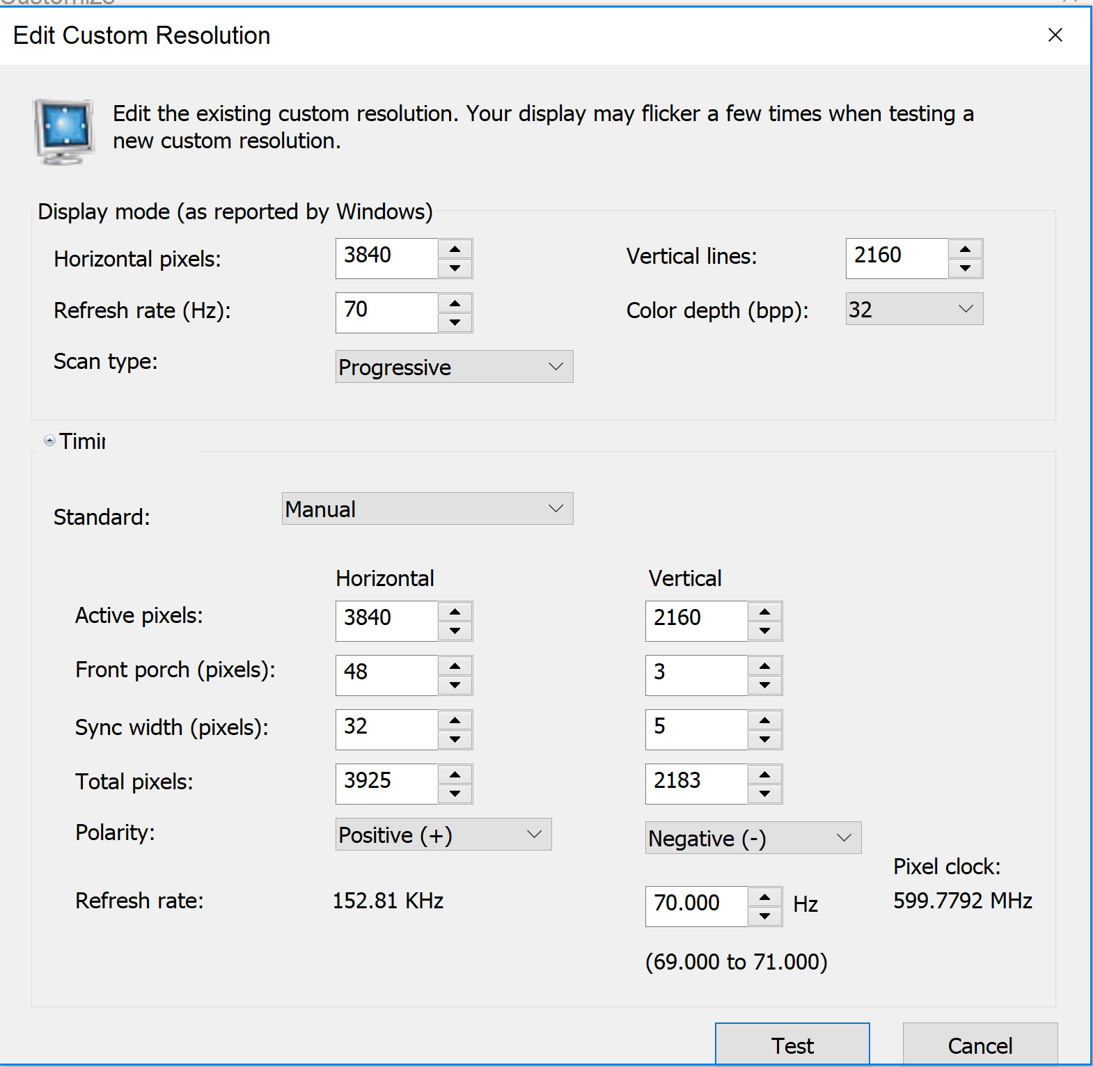

Post: #3321
(12-05-2017 03:27 PM)ToastyX Wrote:
(12-05-2017 12:45 PM)Azazel Wrote:  Is there no way to add a TV resolution data block for 4k@120hz chroma 4:2:0?
There is currently no code for 4K @ 120 Hz.
Thanks for the reply!
Do you know if it will ever be possible to specifically choose chroma resolution? I was thinking of tricking the display by getting ride of all RGB, 4:4:4 and 4:2:2 values so it has no choice but to use 4:2:0 with the specified resolution and refresh rate. I don't think it will work though, so I've opted to try and at least get 4k@72hz to work, "which does fit within the 600.00MHz constraint", but all I've managed to get working is 4k@70hz RGB, verified through UFO Test.
I've uploaded different values that seem to work ok. Any idea's on how to tweak them?
