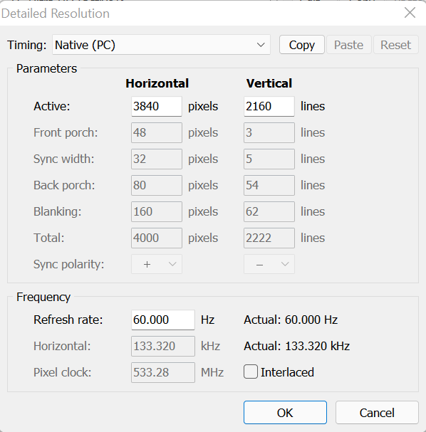

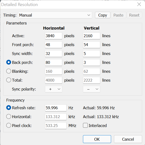

04-02-2022, 01:53 PM
Post: #6510
Hello, one thing I do not understand, what exactly is back porch, and why is the value different on my monitor?
When I reset my monitor I get the values back porch 3 lines, but native PC changes this value to 54 lines, all other values are the same.
I actually mostly just change the refresh rate to a smooth 60, you can argue about that now, but that has nothing to do with back porch.
The problem I have, whenever I change some things, I feel like I get headaches and migraines quickly, because I'm very prone to them, even if I don't feel like the monitor is different because of my settings.
I attach my settings, maybe someone has time and desire to look over whether I do something wrong.
.bin  default.bin (Size: 256 bytes / Downloads: 752)
.bin  Backup.bin (Size: 256 bytes / Downloads: 700)
