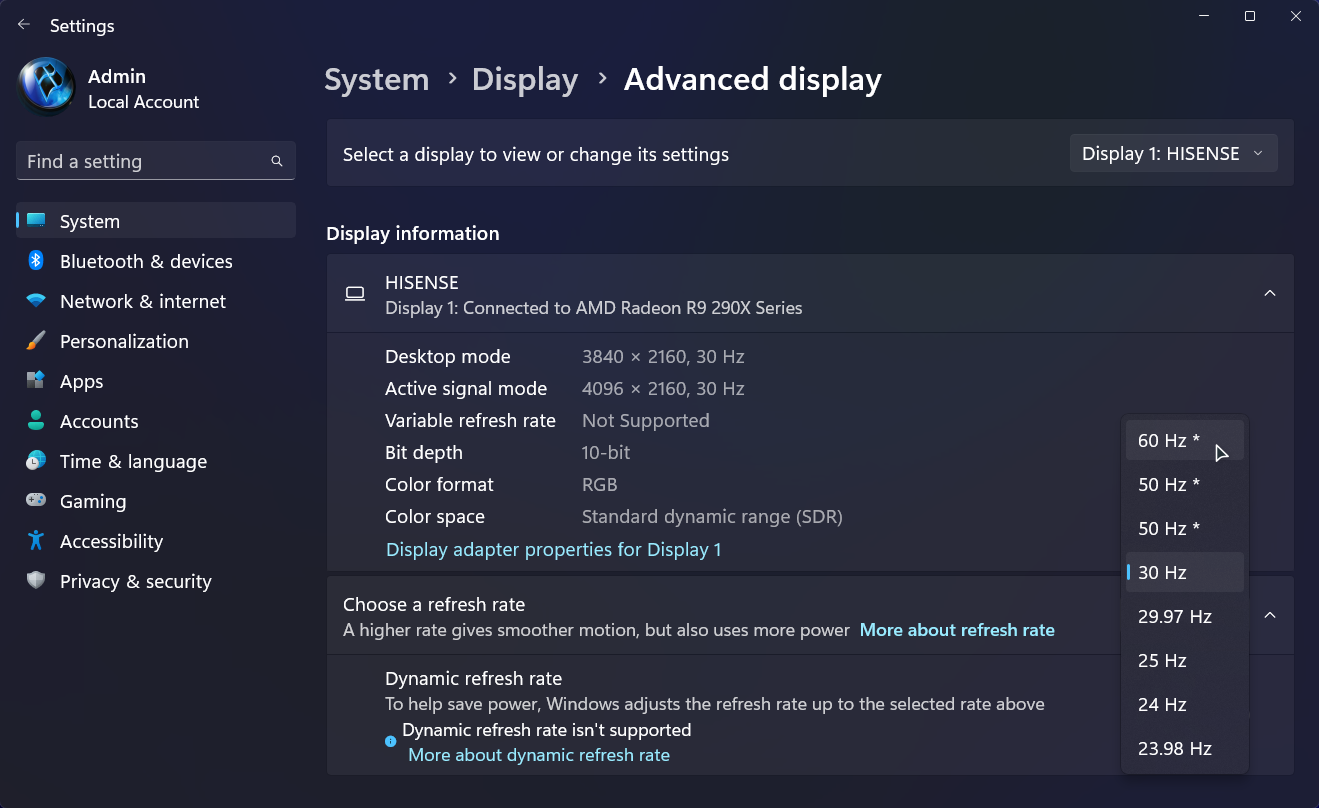

Hi I had a question, because my 43a6h hisense is blinking no display so i bought a 43a7n hisense which is going black on occasion, like every 10 seconds or so at 4k30 & this adapter https://www.bestbuy.com/site/insignia-di...Id=6471859 for my R9 290
I cannot seem to get 4k60 out of the displayport on the R9 290, advice?
*Update*
I had to increase my vddci undervolt from 900mv to 1000mv, and kept my 900mv mvddc memory module voltage, all is well, but still no 60hz 4k... Do I need a usb extra power active displayport 1.4 to hdmi 2.0 adapter, instead... If so which one?
03-22-2025, 02:51 PM
Post: #8948
(03-21-2025 10:01 PM)chris89 Wrote:  Hi I had a question, because my 43a6h hisense is blinking no display so i bought a 43a7n hisense which is going black on occasion, like every 10 seconds or so at 4k30 & this adapter https://www.bestbuy.com/site/insignia-di...Id=6471859 for my R9 290
You need to set the bit depth to 8-bit. Blinking is usually a signal quality problem, either with the adapter or the cable.
(03-21-2025 10:01 PM)chris89 Wrote:  *Update*
Why are you messing with the voltage? You're doing all this weird stuff without telling me and nothing is working like it should. All of this stuff should be plug and play and just work without messing with anything. You shouldn't need extra power unless you're using a long cable.
