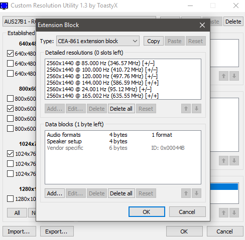

RE: New PG278QR getting 143HZ instead of 140Hz Why? Please help
(05-17-2017 04:46 PM)ToastyX Wrote:  Your answer doesn't make sense. Does CRU 1.3 read the extension block or not? What do you mean by default without any extension? There should be an extension block. Does your laptop have switchable graphics?
Hello my friend again
I can tell you i´m not familiar with this tool, what i did was run CRU, saw what was in the detailed resolutions, and there was only something like the picture attached (ATTENTION THIS IS NOT MY PICTURE, i´m not at home right now, i just download it from google to explain you this better, latter i can post the real one), where instead of saying 60HZ only says 59Hz, the other options (120Hz, 144Hz) didn´t show up.
So i edit that option and put 60Hz and add the others 120Hz and 144Hz, clicked on OK, and close the program, then i try some games, all of them gave me the same result, no changes
In the standard resolutions it was empty like the picture
And in the Extensions Blocks, show something like that, but regarding the Displayport 1.2 that i have connected
After tested all this, i go to Detail resolution again, and delete everything. Now everything is blank on that square
I didn´t notice any changes, everything is the same, but as i told you, i´m not familiar with the tool, and didn´t find a deep tutorial about the tool, only things like "change this and that".........what i have done, but without any results at first sight
(05-17-2017 05:02 PM)Al_Jourgensen Wrote:  And in the Extensions Blocks, show something like that, but regarding the Displayport 1.2 that i have connected
I need to know if CRU 1.3 can read the extension block because that's where the refresh rates are. Show me when you get home.
(05-17-2017 05:02 PM)Al_Jourgensen Wrote:  After tested all this, i go to Detail resolution again, and delete everything. Now everything is blank on that square
Why did you do that?

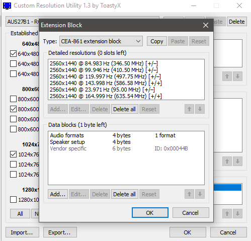

Hello my friend
I´m sorry for the late reply, but i needed to format my notebook again...
Ok so now i have the CRU with virgin results, and here it is
Good. That means it can read the extension block. What do you see when you edit the extension block?

(05-21-2017 02:37 AM)ToastyX Wrote:  Good. That means it can read the extension block. What do you see when you edit the extension block?
This

That's not the extension block. The extension block is in the bottom list.

(05-21-2017 04:46 AM)ToastyX Wrote:  That's not the extension block. The extension block is in the bottom list.
what do you mean?
This?

Are you still having problems after reformatting? What happens if you change 143.998 Hz to 144 Hz and 119.997 Hz to 120 Hz?

Now everything flashes when i open a game, like on/off, black screen/game, i could see in game that the Refresh rate is the same, 119, 143
How do i recover this?
(05-21-2017 09:21 PM)Al_Jourgensen Wrote:  Now everything flashes when i open a game, like on/off, black screen/game, i could see in game that the Refresh rate is the same, 119, 143
I restarted seems to be stable now, but nothing as changed in game menu, still the same refresh rates

You can run reset-all.exe and reboot to restore everything back to the way it was. I don't see why games would list 119 Hz or 143 Hz if it's not defined like that, but such a small difference shouldn't matter. What about 3D Vision? Is that still not working?
