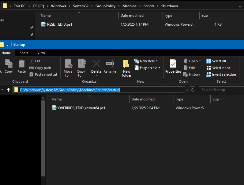

3. Using notepad, create a shutdown script that tells the system to run each of your EDID override .exe files with the " /r " option which will tell them to reset each one to their defaults at shutdown. And create a startup script that tells the system to run those same .exe files with the " /i" option to apply them at startup with no prompts. The startup script MUST end with running "restart64 /q" to initialize the changes!!
(Not 100% sure if this is required, but my scripts ended up in the "C:\Windows\System32\GroupPolicy\Machine\Scripts\Startup" and "C:\Windows\System32\GroupPolicy\Machine\Scripts\Shutdown" folders. )
4. Use Group Policy Editor if using Windows 10/11 Pro (or alternative like PolicyPlus that provides similar functionality in Home editions) to tell the system to run the shutdown script at shutdown and the startup at startup.
... and really, that's it! Just make sure to reset your EDID overrides before you shutdown the first time if you have dual monitors and suffer from the black screen issue. There will be a brief black flash once the login screen has appeared since restart64 is being run in the background, but you can still type your pin\password while this is happening so it is minimally invasive, especially if you have the lock-screen disabled (which you should unless you're using a tablet).
