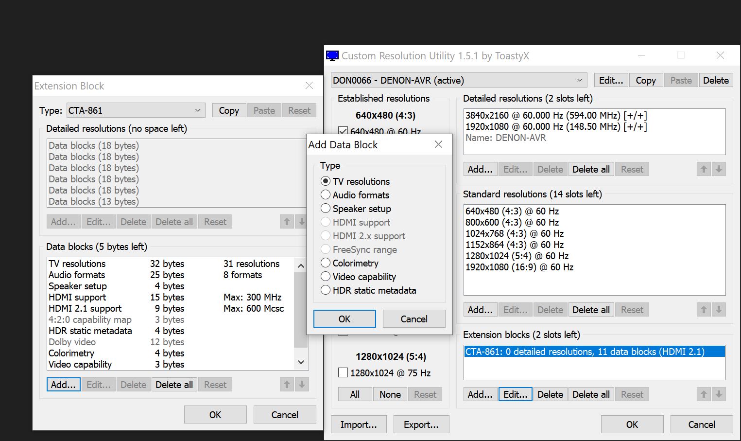

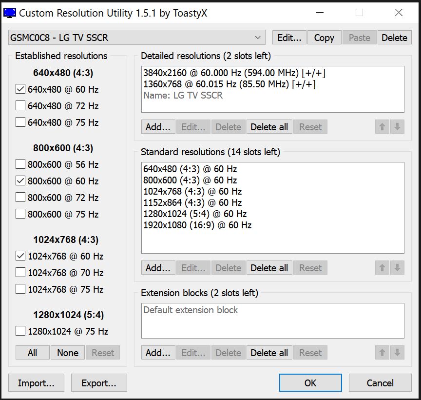

I need to see the EDIDs to see what's going on. Export a file with and without the receiver and attach them here.

The LG C1 seems to support both HDMI 2.1 VRR and FreeSync, but the Denon only supports HDMI 2.0, and it removed the FreeSync data block with no space left to add it back in, so I removed a bunch of unnecessary resolutions like 4096x2160 and lower TV resolutions that are ignored by the driver, and then copied the FreeSync data block to the Denon EDID.
