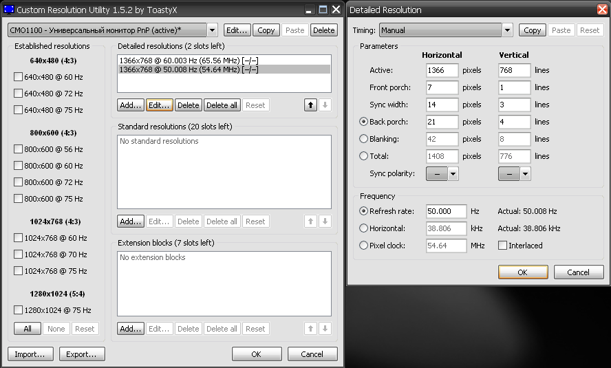

11-17-2023, 03:29 PM (Last edited: 11-17-2023, 03:49 PM by evgs)
Post: #7758
I'm so confused, can you help me?
I have almost same two old laptops/netbooks: Asus eeePC 1015PEM (intel GMA3150 only) and 1015BN (GMA3150 + Nvidia ION2).
Both of them have identical TN-matrix (1024x600 native res)
I want to add 50Hz mode for smooth emulation of European C64, PAL NES and other old retro videogame emulators running at PAL mode.
I've added 50Hz mode for 1015BN (ION2 mode) using CRU 1.5.2 and it runs perfectly!
I used template for 65Hz, that was already present in current driver.
res: 1024x600
Front porch: 93/17
Sync width: 35/5
Back porch 88/16
Refresh: 50.000 Hz
I try to do same job on second netbook (GMA3150) using standard method or EXE-export, but no luck.
.txt  edid-dump.txt (Size: 445 bytes / Downloads: 569)

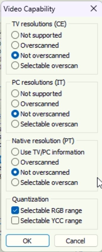

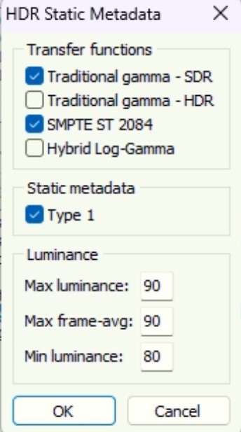

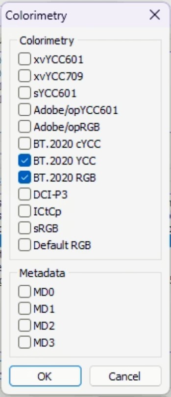

11-17-2023, 03:50 PM (Last edited: 11-17-2023, 03:57 PM by leandroromao86)
Post: #7759
(11-17-2023 02:13 PM)ToastyX Wrote:
(11-17-2023 10:15 AM)leandroromao86 Wrote:  I ran the edid-dump executable, it opened a command prompt or 2 and instantly closed and generated the dump. It is attached.
Import the edid-dump.txt file using CRU. Then edit the CTA-861 extension block. Then edit the HDR static metadata block. Then enable the "Type 1" checkbox. Then click all the OK buttons and reboot. See if that works.
Thanks for the answer.
Tried it but got no luck. Windows still says monitor does not support HDR. Funny fact is that it supports HDR via HDMI, but at a much lower frame rate and I lose FreeSync support (VRR).
Do I have any other options?
Thanks again.
Edit: found some options that can be related to HDR, should I mess with them? Screenshots are attached.
Thanks!
11-17-2023, 04:42 PM (Last edited: 11-17-2023, 05:44 PM by evgs)
Post: #7760
I've just added 50Hz to Acer 1830T laptop (intel HD graphics, ver.8.15.10.2993, 30-jan-2013) using *.EXE-export method.
It really works like a charm, thank you for great software!
But i have a doubt, did I do it right way?
I've copy-paste all the parameters (front porch, sync width, back porch) from existing 60Hz mode, which actually presents at default EDID
Is it correct? Maybe i need different parameters?
.txt  edid-dump-acer1830t+50hz.txt (Size: 445 bytes / Downloads: 539)
