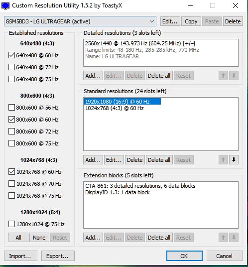

Post: #7912
(01-15-2024 07:36 PM)Adrianos Wrote:  I really appreciate the explanation, I understand now. There is nothing there. I have one default extension block with no resolution and one named Display ID 1.3: 1 data block. This one is having my native in Display ID 1.3 and Display ID 2 with 2 different refresh rates. By the way, I will break something if I delete this extension block? I remembered that in CRU and also SRE, I deleted 1920x1080 resolution, but still appears in AIDA at video modes and control panel / display settings. Thank you very much!
Later Edit: One more question, please. If i deleted my native res from SRE and I still have it on CRU is there any difference?
"Default extension block" means CRU couldn't read the extension block. Default extension blocks don't work with NVIDIA, so no changes will take effect if one exists. The first extension block is normally CTA-861. Are you using DisplayPort or HDMI? I haven't seen a case where the first extension block is default but the other ones are readable. Was it like that originally? Run reset-all.exe and restart. Then run this and post the test.txt file here: https://www.monitortests.com/EDID-test.zip
Resolutions shown in CRU always take precedence over any scaled resolutions, so you can delete all the resolutions from SRE, even the native resolution.

01-16-2024, 09:51 AM (Last edited: 01-16-2024, 10:04 AM by Adrianos)
Post: #7914
I don't think I have explained correctly, sorry if i didn't. The settings with extensions block were there before, they are the original ones. I'm using DisplayPort. I have run the reset-all.exe and restart and the test that you provided.
Lated Edit: Wow, now it shows differently in CRU, after the reset. I think is exactly what you said it should look. What could might happen? I'm pretty sure I have run the reset 2 days ago.

01-16-2024, 02:46 PM
Post: #7915
(01-16-2024 09:51 AM)Adrianos Wrote:  I don't think I have explained correctly, sorry if i didn't. The settings with extensions block were there before, they are the original ones. I'm using DisplayPort. I have run the reset-all.exe and restart and the test that you provided.
I don't know, but now that you have the correct data, you can just delete the TV resolutions data block in the CTA-861 extension block and delete the standard and established resolutions in the main window and you'll be left with only 2560x1440. NVIDIA's driver might also add 1768x992 and 1176x664, but that seems to be hard-coded in the driver for some reason.

01-16-2024, 05:15 PM (Last edited: 01-16-2024, 05:15 PM by Adrianos)
Post: #7917
I did delete the TV resolutions and all the resolutions that I didn't needed are gone now, even 1768x992 and 1176x664 in display settings. My initial issue with stuttering / freeze is now gone and as a bonus, Windows is even faster now. After 3 days of troubleshooting I can finally "rest", thank you so much!! It's strange that the issue with NtGdiDdDDIGetDisplayModeList is not popular. From my understanding, when you restart your computer and open an app, the first app freezes for 1-2 seconds due to high latency system call, checking all the available resolutions (the more resolutions and higher refresh rate, the "harder" is the stutter). This is happening also after the monitor wakes from sleep. Maybe someone with the same issue will not spend 3 days of troubleshooting and finds this post. Again, thank you so much!
