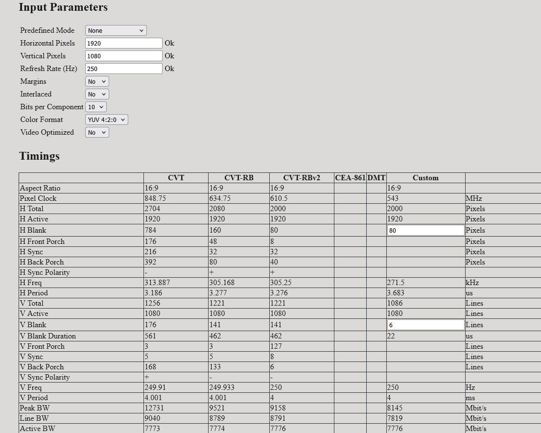

Im currently using a dual gpu system (non mux) with an intel uhd 630 and gtx 1650, and I wanted to know if custom resolutions above 300 or 340 mhz would work, since the hdmi out comes from the intel gpu. Im aware there isn't a pixel clock patcher for intel, but I think I heard you mention something about HDMI support display block a while ago. Would setting the max TMDS clock bypass this? I just want to make sure since my new 1440p 360hz monitor still hasn't arrived and I plan to use a custom resolution of 1920x1080@250 for competetive gaming, since that's the max on hdmi 1.4 at 10bit with yuv 4:2:0.
I used this tool to figure that out: https://tomverbeure.github.io/video_timings_calculator
Also Regarding this tool, the 1920x1080@250 is 543 mhz, obviously far higher than the advertised limit for udh630 and hdmi 1.4; however, It claims that it's possible to work either way. Is this because it doesn't count the gpu pixel clock limit or is this a program error?
Thanks in advanceBig Grin

(08-06-2024 08:14 PM)Jen Wrote:  Im currently using a dual gpu system (non mux) with an intel uhd 630 and gtx 1650, and I wanted to know if custom resolutions above 300 or 340 mhz would work, since the hdmi out comes from the intel gpu. Im aware there isn't a pixel clock patcher for intel, but I think I heard you mention something about HDMI support display block a while ago. Would setting the max TMDS clock bypass this? I just want to make sure since my new 1440p 360hz monitor still hasn't arrived and I plan to use a custom resolution of 1920x1080@250 for competetive gaming, since that's the max on hdmi 1.4 at 10bit with yuv 4:2:0.
Well the pixel clock limit is assuming 8 bpc 4:4:4. 4:2:0 uses half the bandwidth, so in theory it can be done, but in reality there isn't a way to add custom 4:2:0 resolutions for HDMI 1.4 other than 3840/4096x2160 @ 50/60 Hz. Technically 4:2:0 wasn't supported until HDMI 2.0, but some drivers implemented 4:2:0 for 3840/4096x2160 to allow 50/60 Hz with HDMI 1.4.

Alright I see. Thank you so much for your support Big Grin
I'll see what can I do with yuv 4:2:2 instead
