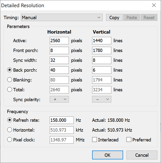

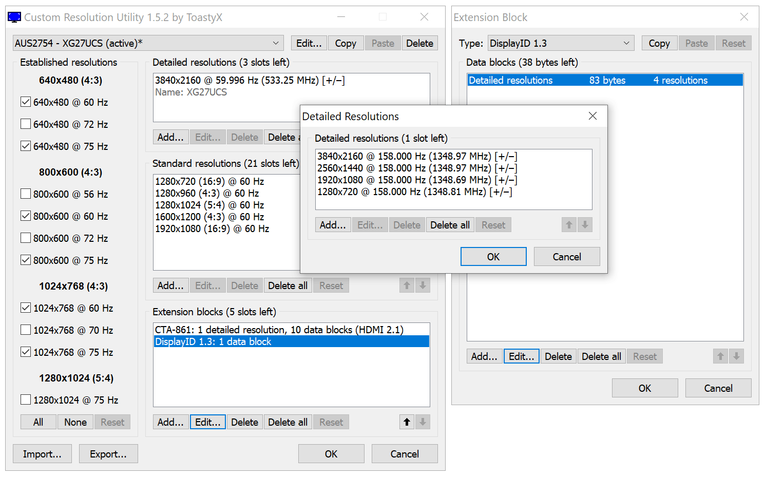

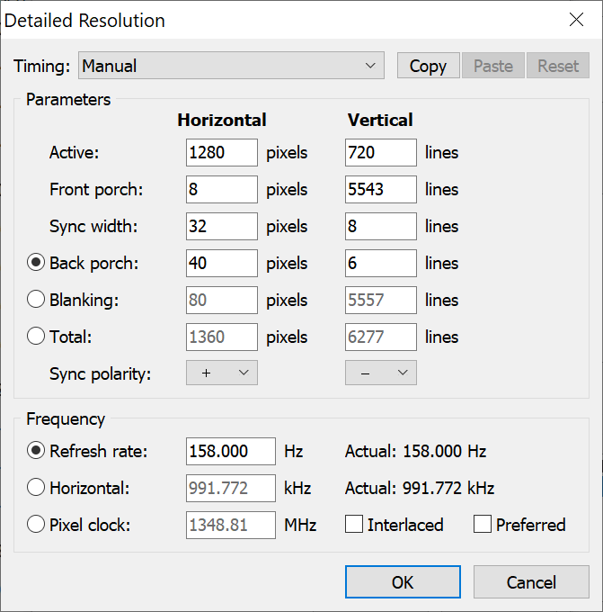

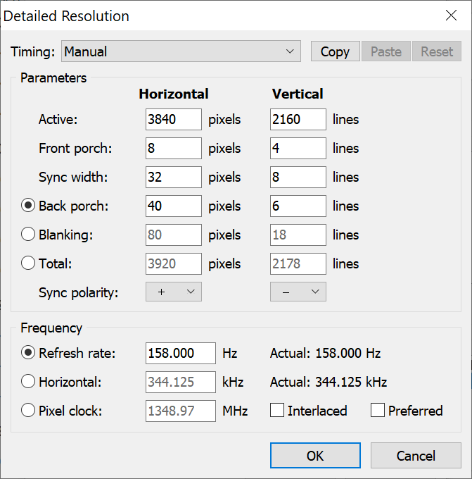

09-30-2024, 09:48 PM (Last edited: 10-02-2024, 02:52 PM by ikonomov)
Post: #8514
I've done some further testing with the XG27UCS monitor (using HDMI 2.1 cable) that I thought worth reporting since my last post.
1. At 720p it seems that the lowest accepted Horizontal Blanking is 80 pixels (same as CVT-RBv2), anything lower results in blank screen.
2. Vertical Blanking must be at least 11 lines.
3. Maximum Vertical Back porch is limited to 2047 lines.
4. Although lowering the input lag might not be very significant (I can't really detect a difference) by increasing the vertical totals (QFT) at 1440p, 1080p and 720p resolutions by adding them (in addition to 4k) in the DisplayID 1.3 extension block, there is a benefit of having faster transition when changing resolutions. I'm not sure if this is something related to Windows, but switching between these four resolutions happens almost instantly more often when all four 158Hz resolutions are present in the DisplayID 1.3 extension block than when it's only the 4k resolution. I'm not sure if those resolutions with their increased vertical totals are actually used, it could be that the 4k 158Hz resolution values are used for everything else, but it seems there is some benefit of having them added.
Edited with some further testing.
