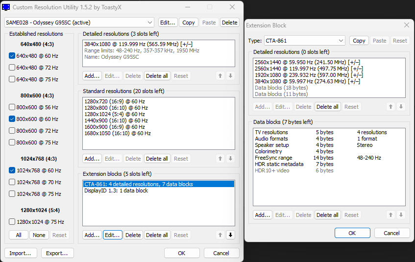

I'm having major issues with my new Odyssey G95SC (LS49CG950SUXEN).
Whenever I try to set it at more than 60Hz the screen looses its connection to my PC and I get an error screen.
I've tried different HDMI 2.1 cables as well as different DP 1.4 cables on all of the ports on my GPU which is an PowerColor Radeon RX 7900XTX Hellhound 24GB.
I'm currently testing CRU a bit but have no experience in the application. Could someone assist me and perhaps recommend me settings that I could try to get this sorted?
The screenshot shows my current settings for the screen (default).
12-18-2024, 03:09 PM

(12-18-2024 12:41 PM)Kapten Wrote:  I'm having major issues with my new Odyssey G95SC (LS49CG950SUXEN).
I don't know what you're expecting. You shouldn't use CRU to try to fix problems that shouldn't exist in the first place. What is the error screen you are getting?
