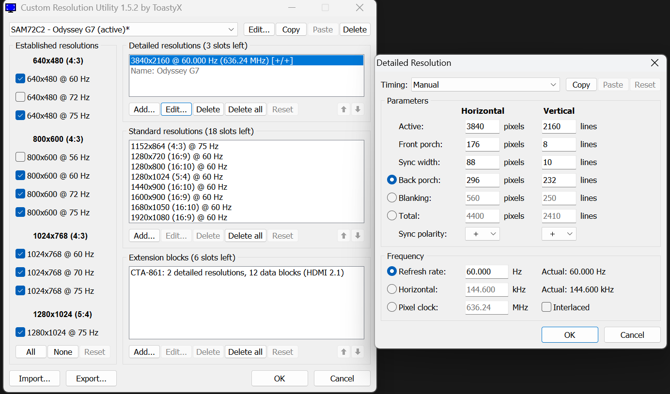

I realize that I might have to play around with the monitor settings through CRU, but I don't know which handles to pull and by how much. I tried fiddling around with "blanking", but honestly I don't know what value I should be using and why.
Can someone point me in the right direction?

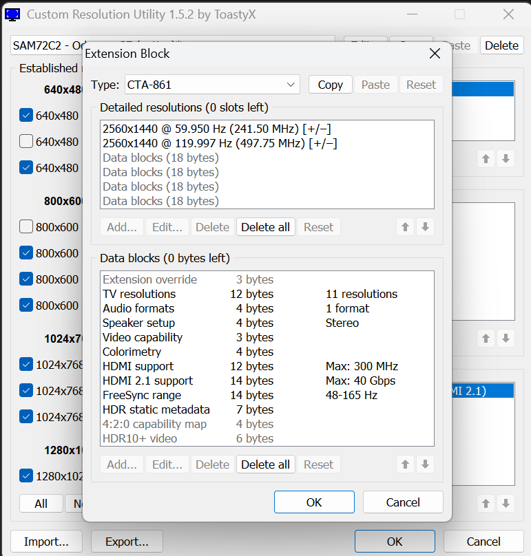

I have attached the settings from CRU.

The monitor has additional extension blocks that CRU doesn't currently show. The default 165 Hz does have reduced vertical blanking, but I'm not sure if the monitor can handle the normal amount. Try importing this file:
.bin  G7.bin (Size: 384 bytes / Downloads: 391)

(04-10-2025 08:51 PM)ToastyX Wrote:  The monitor has additional extension blocks that CRU doesn't currently show. The default 165 Hz does have reduced vertical blanking, but I'm not sure if the monitor can handle the normal amount. Try importing this file:
Thanks.
I can import and apply the settings (with restart.exe) and the monitor displays everything correctly, but unfortunately there is no change in VRAM frequency and the power consumption goes up.

Do I need to change additional settings other than loading the file?
I have tried fiddling a bit with the blanking time in both the native resolution and the extension block, but I can't get it to work.

Normally with a single monitor, increasing the vertical blanking is the solution, so if that's not working, then there must be some other limitation causing the VRAM clock to not drop when idle. Maybe it's because of DSC. You'll have to ask AMD support about that because I'm not aware of any other limitations that would cause this.

A couple of additional questions:
- Can I raise the vertical blanking as much as I want, or is there a limit? (Maybe there is no reason to do so?)
- Do I need to raise the vertical blanking in the native/detailed resolution section, in the extension block section or both places?
Thanks
