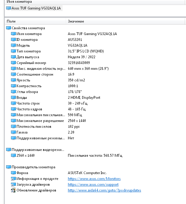

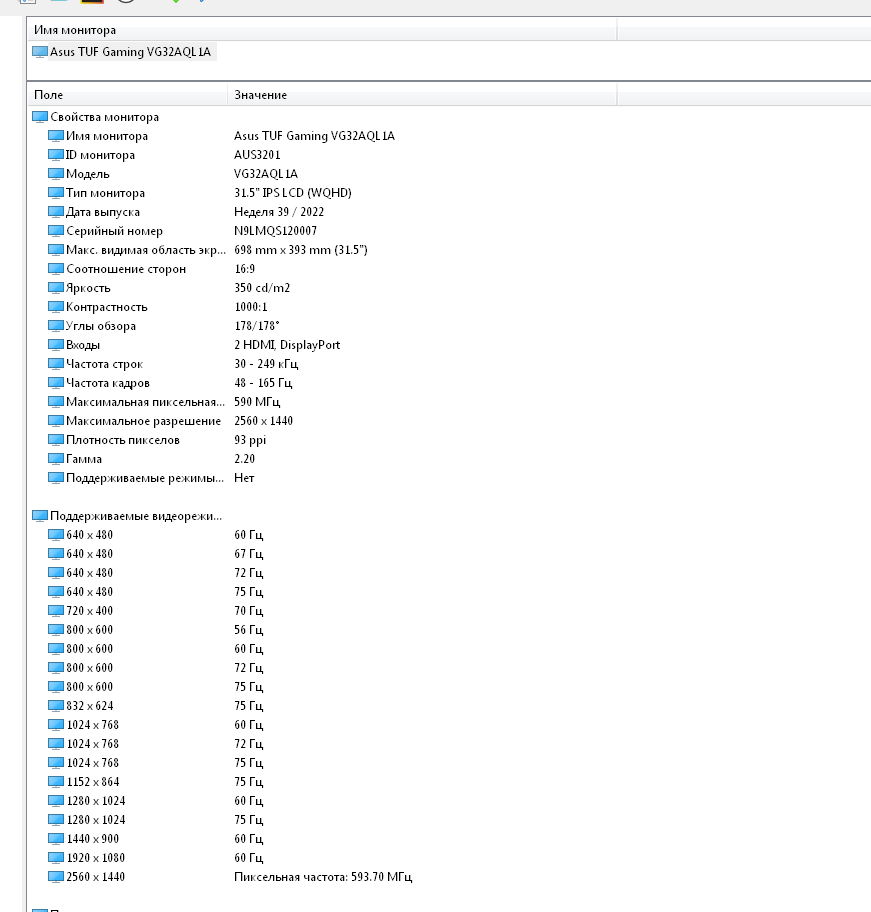

I use you Custom Resolotion Utility , and I can not understand why this so ,when I not use Custom Resolution Utility , my display size detect as 698 mm x 393 mm and 31,5 inc and serial number N9LMQS120007 with 2560x1440 with 93 ppi , when I use Custom Resolution Utility , my display size 640 mm x 360 mm and 28.9 inch , also modiufy serial number to 323916843009 , and also modify ppi from 93 to 102 , why so ? How I can fix this with use Custom Resolution Utility ?

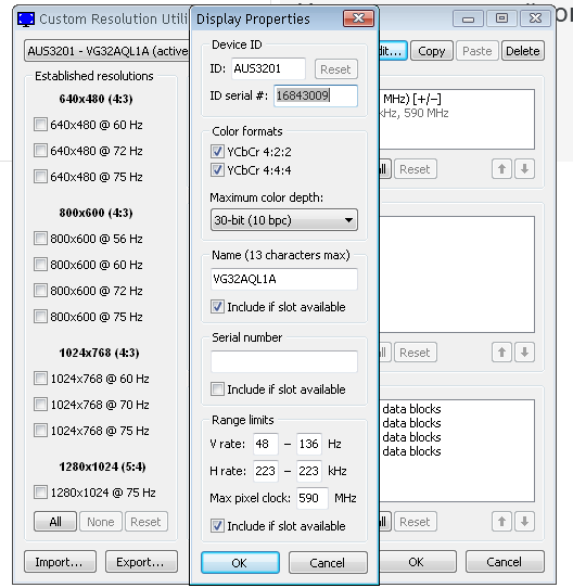

Screen size and image size are two different things. CRU doesn't change the screen size in the EDID. For detailed resolutions, CRU just puts a generic value for the image size because it's not used for anything, which is what's being reported in the screen shot. The PPI is being calculated from the image size. CRU doesn't include the serial number by default to allow one more slot for detailed resolutions. You can include the serial number using the "Edit..." button at the top. I don't know where it's getting 323916843009 from because that's not a valid ID serial number.
CRU wasn't originally intended to be a complete EDID editor, so it handled certain things automatically to make things simpler. I'm currently rewriting CRU from scratch to be a complete EDID editor, so the new version won't make these changes. I hope to release a test version later this year.

As for serial number , this do in here
323916843009
-----16843009
serial formed from this values

I do not agree with you , PPI not link with working resolution , for example my work resolution is 2000x1125 , this because my eyes do not have perfect vision)
and if I add custom resolution in nVIDIA drivers , PPI as was 93 , so was leave 93 , but if I use CRU , PPI It changes even if work resolution leave 2560x1440 ) because modify monitor size from 31,5 inch to 28.9 inch )
I'm saying the PPI reported by the program you are using is calculated from the reported image size. It's not the actual PPI. The actual PPI would increase with lower resolutions. The NVIDIA control panel is not an EDID editor, so it would not change the reported image size. This image size is only informational. Windows does not use the image size information for anything, which is why I didn't include it and just set generic values. The new version will let you edit the image size, but that won't affect anything.

(07-18-2025 02:01 PM)cru_user Wrote:  As for serial number , this do in here
323916843009
-----16843009
I don't know where it's getting the 3239 part from. That wouldn't be in the EDID. Also 16843009 is just 0x01010101 in hex, which means the monitor just reported a generic value, so the 3239 is not supposed to be there. Windows doesn't use the serial number for anything either, so it doesn't really matter anyway.
