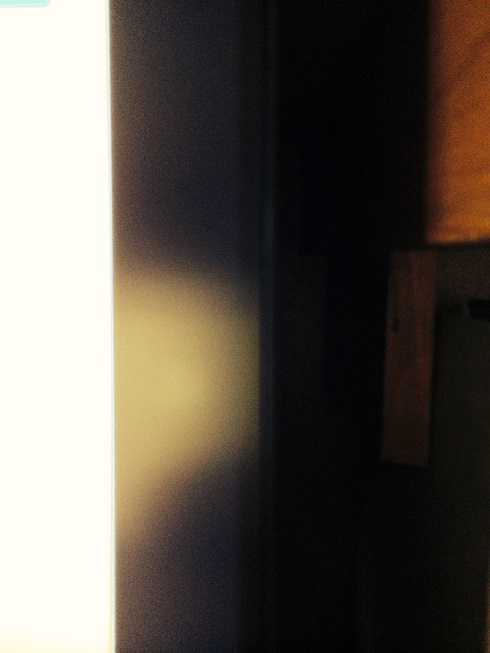

Thank you for the upload. I have a problem that I am hoping you will be able to assist me with. I'm using a Dell Inspiron 1720 laptop, with an NVIDIA 8400M GS graphics card. It has a VGA out, which I have connected to an active VGA - HDMI converter. This is connected to a Dell U2414H monitor via HDMI. The native resolution of the monitor is 1920 x 1080 @ maximum of 60Hz. Standard Windows 8.1 resolution options do not include 1920 x 1080 so I downloaded your software. I added "1920 x 1080 @ 60Hz" under standard resolutions, and restarted. The monitor is clearly displaying a 1080p resolution as intended. However: The image is shifted around 100-200 pixels to the left. Please see the attached photo. There is a distinct black bar between the end of the image displayed on the screen, and the edge of the monitor. Please help, this is very frustrating. Thank you. |

(08-24-2014 10:25 AM)blimeyoriley Wrote: I added "1920 x 1080 @ 60Hz" under standard resolutions, and restarted. The monitor is clearly displaying a 1080p resolution as intended. However: The image is shifted around 100-200 pixels to the left.The first detailed resolution is considered the native resolution. Add it as a detailed resolution using the "LCD standard" timing option. Standard resolutions won't use the right timing. |

(08-24-2014 12:48 PM)ToastyX Wrote:(08-24-2014 10:25 AM)blimeyoriley Wrote: I added "1920 x 1080 @ 60Hz" under standard resolutions, and restarted. The monitor is clearly displaying a 1080p resolution as intended. However: The image is shifted around 100-200 pixels to the left.The first detailed resolution is considered the native resolution. Add it as a detailed resolution using the "LCD standard" timing option. Standard resolutions won't use the right timing. Thank you for your quick reply. I've done that, still got the same issue. I've also tested a different laptop (ATI Graphics Card) and a different monitor, and they all suffer from the same issue. I think it is to do with timing but I have no idea how to rectify it. |

(08-24-2014 03:05 PM)blimeyoriley Wrote: Thank you for your quick reply.If "LCD reduced" doesn't work either, then it's probably an issue with the adapter. |
