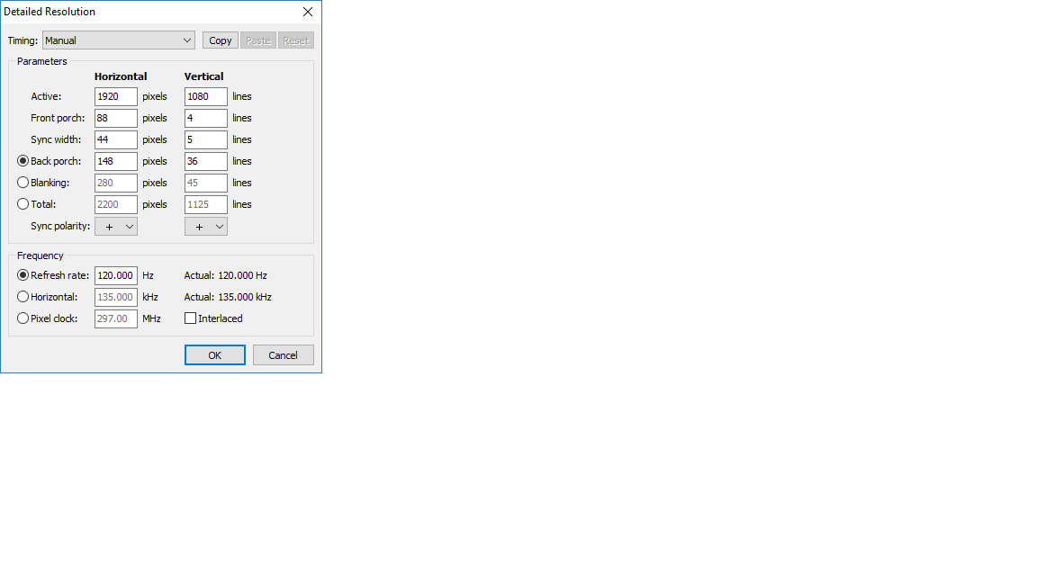

(01-13-2017 01:34 AM)ToastyX Wrote:
(01-13-2017 12:38 AM)billycarter86 Wrote:  Hey ToastyX. I was wondering if you could help me out. I am currently using a Vizio E552VLE Television as a monitor. I have already pushed the television successfully to 120HZ.
The problem I have is that once I overclock the tv, I lose all audio. I have tried using different audio outputs but to no avail. I use HDMI for audio and video from my system. If I use Radeon Relive I can overclock to 95hz max and still keep audio.
What timing parameters did you use? Try the "LCD native" timing option. "LCD standard" at 120 Hz does not have enough horizontal blanking for the audio data.
I am currently useing LCD Native @ 120

(01-15-2017 09:03 PM)billycarter86 Wrote:  I am currently useing LCD Native @ 120
That's a driver issue then. Those are the correct timing parameters for 120 Hz, so there should be audio. Try using a "TV resolutions" data block in the extension block to add 1920x1080 @ 120 Hz as a TV resolution.
