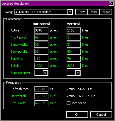

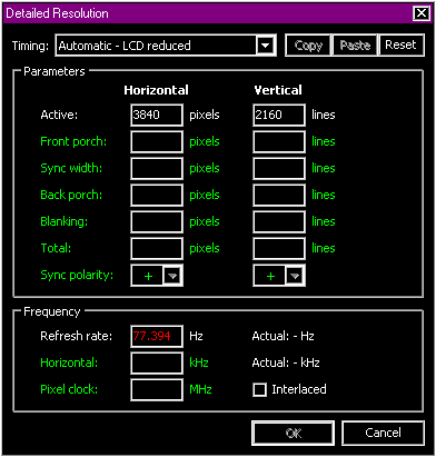

There are users on AVSforum trying to make custom resolutions of 3840x2160 120Hz, but it seems like CRU doesn't let you make custom resolutions with a pixel clock greater than 655MHz, which means you're limited to 77Hz at 3840x2160.
I've attached 4 screenshots showing the issue.
