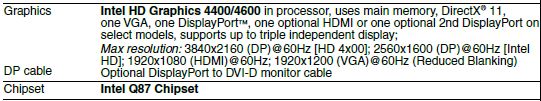

				RE: 4600HD Max pixel clock?
				(02-06-2021 08:51 PM)ToastyX Wrote: I don't know what the DisplayPort limit is for 4th generation Intel GPUs, but if it's accepting 533 MHz, then it should support HBR2, which allows up to 720 MHz with 8 bpc color. I don't know. I tried CRU with the driver I am currently running, but I am either not using CRU properly, I don't understand how to use it properly or it won't work with that driver. or a combination of all 3! ![]() I read the instructions on CRU on this forum, but nothing seemed to work. So I don't know what I am doing wrong. According to the specifications of this machine it shows it should be able to do 3840x2160 @ 60Hz. Which is does. But only at CVT-RB timing. Which is a reduced blanking timing if I understand it correctly. The specs also say something about reduced blanking, so perhaps I am just at the limit of what the hardware/BIOS can do? I will download and install that driver and try again after I get off work. Thank you.  |

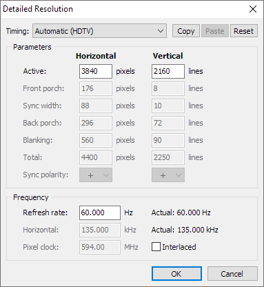

				(02-06-2021 08:51 PM)ToastyX Wrote: I don't know what the DisplayPort limit is for 4th generation Intel GPUs, but if it's accepting 533 MHz, then it should support HBR2, which allows up to 720 MHz with 8 bpc color. Ok so I had some time to try this. I downloaded the driver above and used CRU to add a custom resolution/refresh/timing. CRU does not seem to be adding the resolution to the registry or I am doing something wrong. I add the resolution, get an asterisk next to my display and click OK. Then I run restart-64 and wait for the driver to restart. Once that happens I go into advanced display settings and the refresh rate I added is not there. The resolution I am trying to add is 3840X2160 at automatic (HDTV) timing. I have also tried Native (HDTV) I have also noticed that every time I open CRU there is an asterisk by the display name. This seems to indicate that the changes are not being saved? I don't know. I am following the instruction jn the main CRU thread, but it doesn't seem to be working. :/  |

					* means the changes were saved. Are you able to add resolutions less than 533 MHz pixel clock?
					02-16-2021, 04:46 AM
Post: #8
