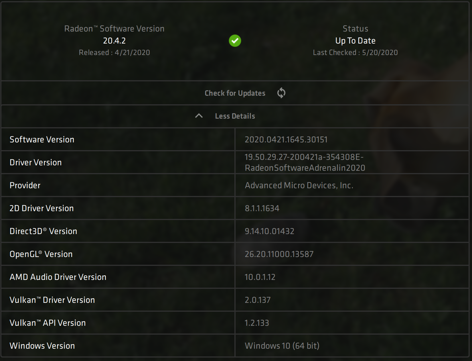

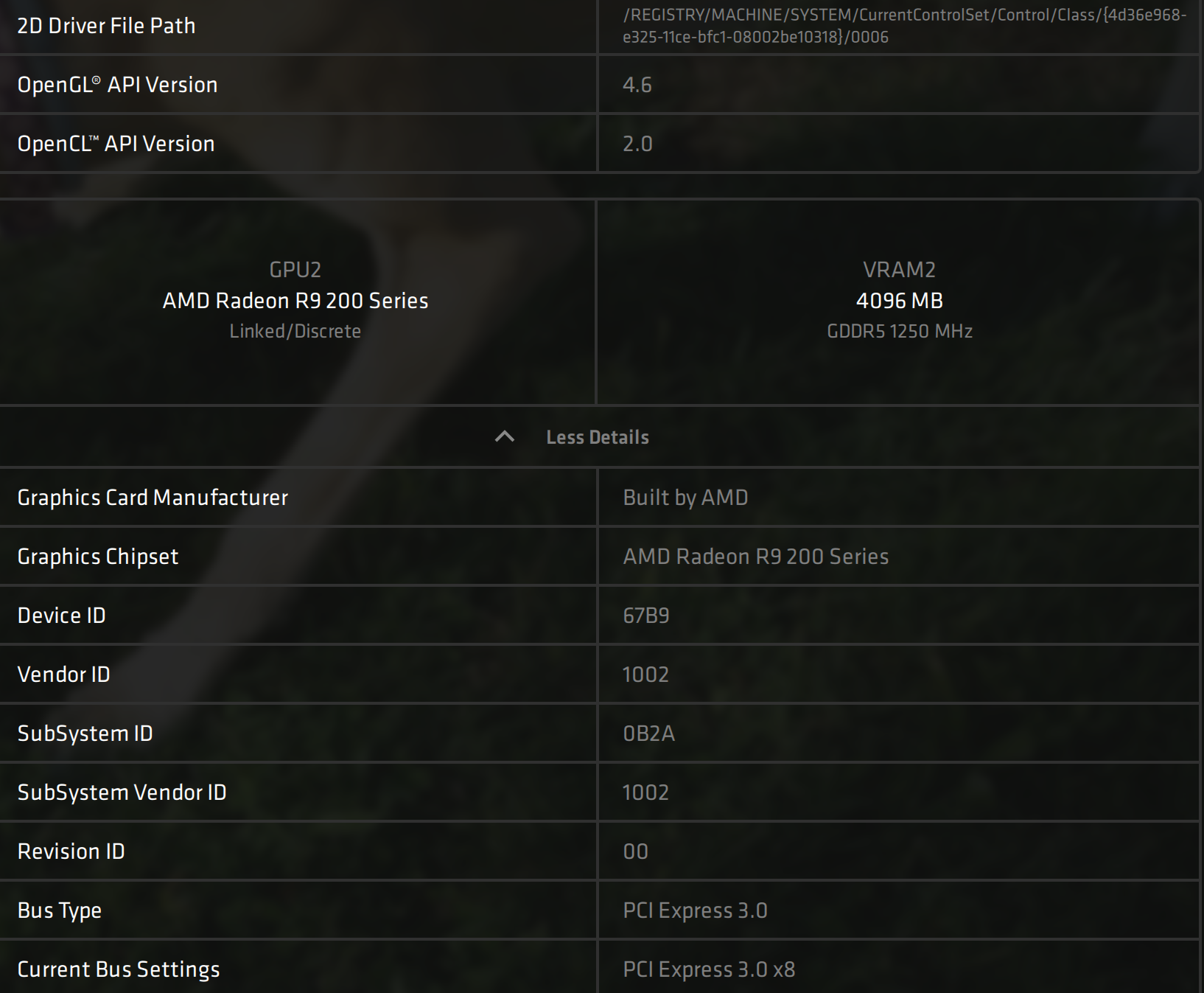

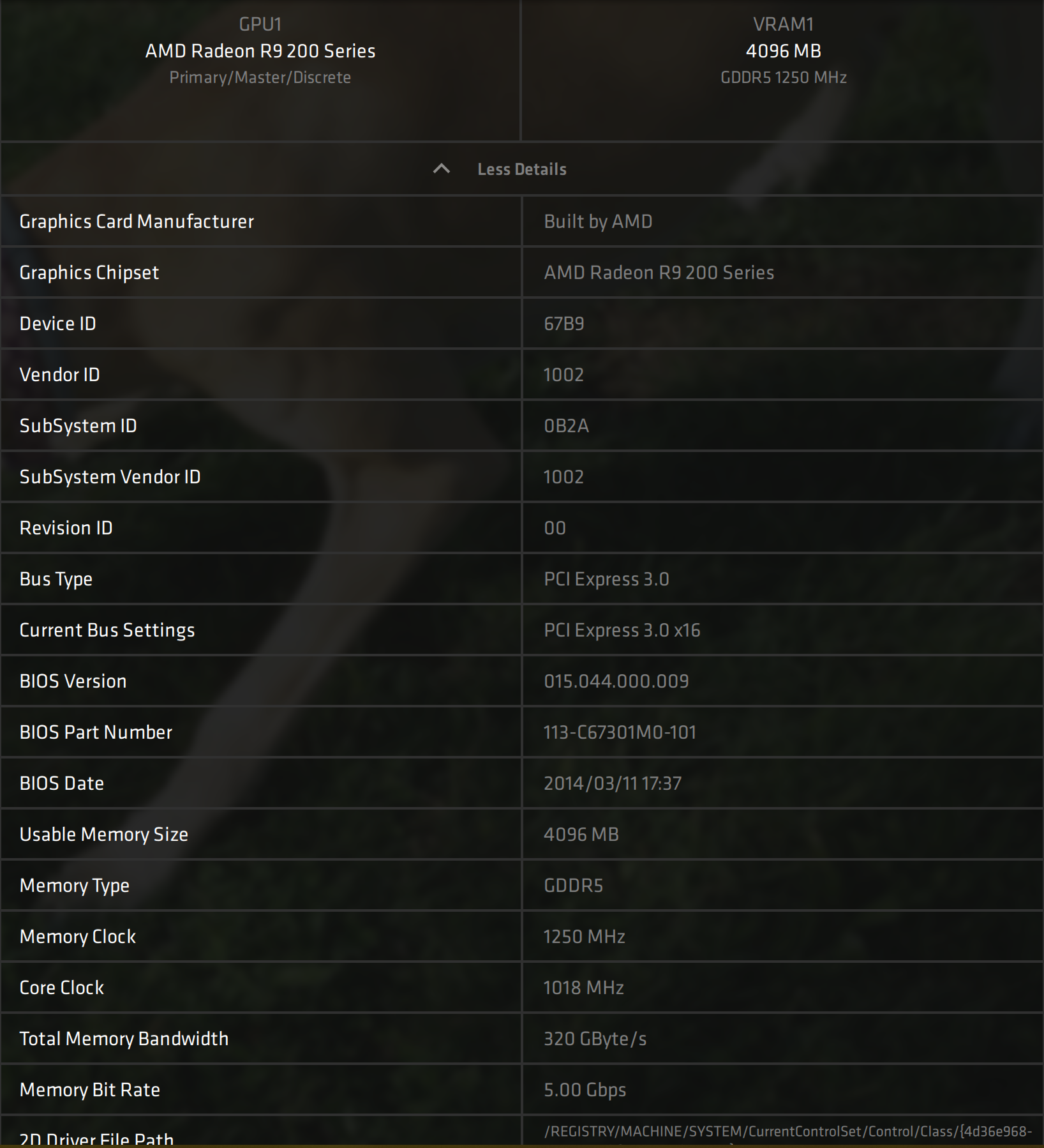

I have attached system info in the attachments.
I have 3 seiki 4k 60hz tv connected by mini DP to HDMI and good quality HDMI 2.0 cables.
Let me be very clear here, this worked just fine up to and including AMD 19.7.5.
Any driver after 19.7.5 The display reports the refresh rate 30hz and the 30hz makes my head hurt.
