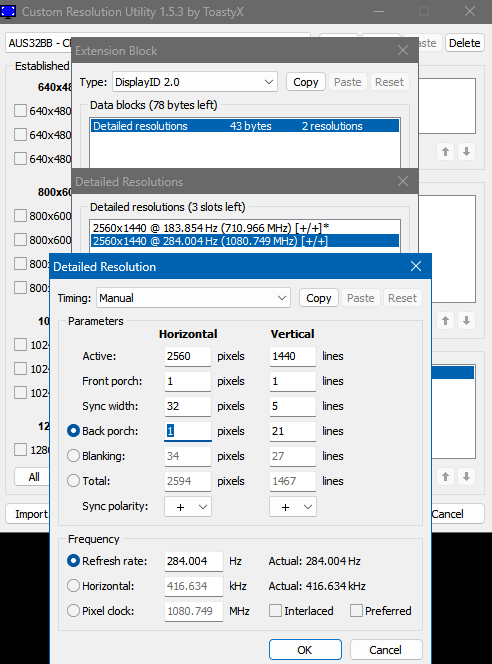

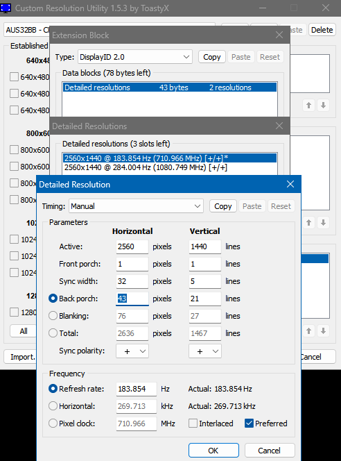

26.1.1 my 184Hz Back Porch Horizontal = 1 26.2.1 my 184Hz Back Porch Horizontal = 43 ( had to increase because artifacts jagged picture ) HOWEVER my 284Hz Back Porch Horizontal = 1 remains working specs > https://pastebin.com/SpqMpJkY make it make sense |

I don't know why that would happen. Usually multiples of 8 for horizontal values are most compatible, but this seems like it wants a minimum blanking of 76.

(02-21-2026 10:01 PM)ToastyX Wrote: I don't know why that would happen. Usually multiples of 8 for horizontal values are most compatible, but this seems like it wants a minimum blanking of 76. found the problem, and it actually happens in previous driver versions to, only difference i wasn't using the script which imports CRU profile, restarts driver and then auto sets 184Hz BEFORE i change to 12bit in adrenaline https://www.youtube.com/watch?v=sDlqGuSLJJ0 |
