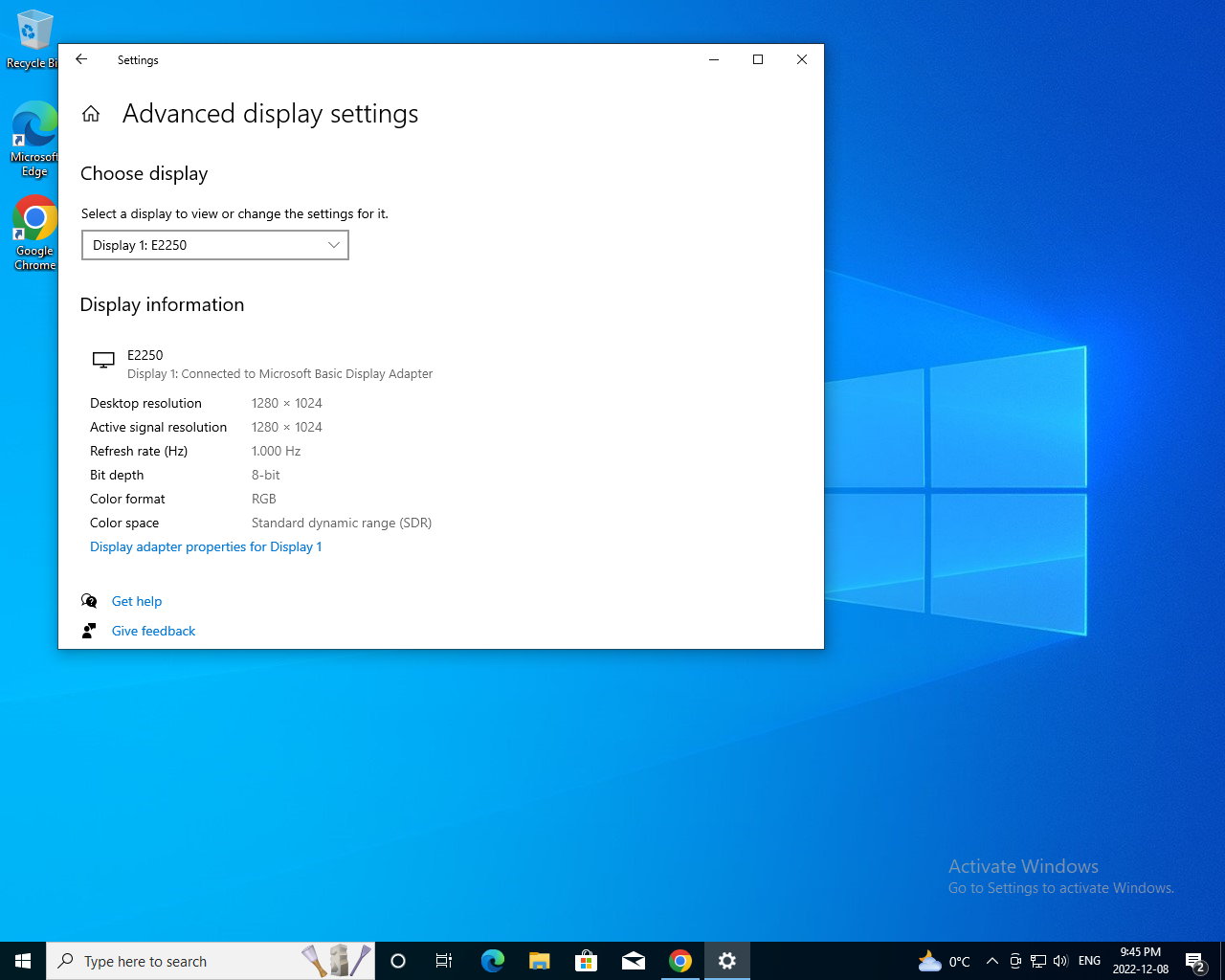

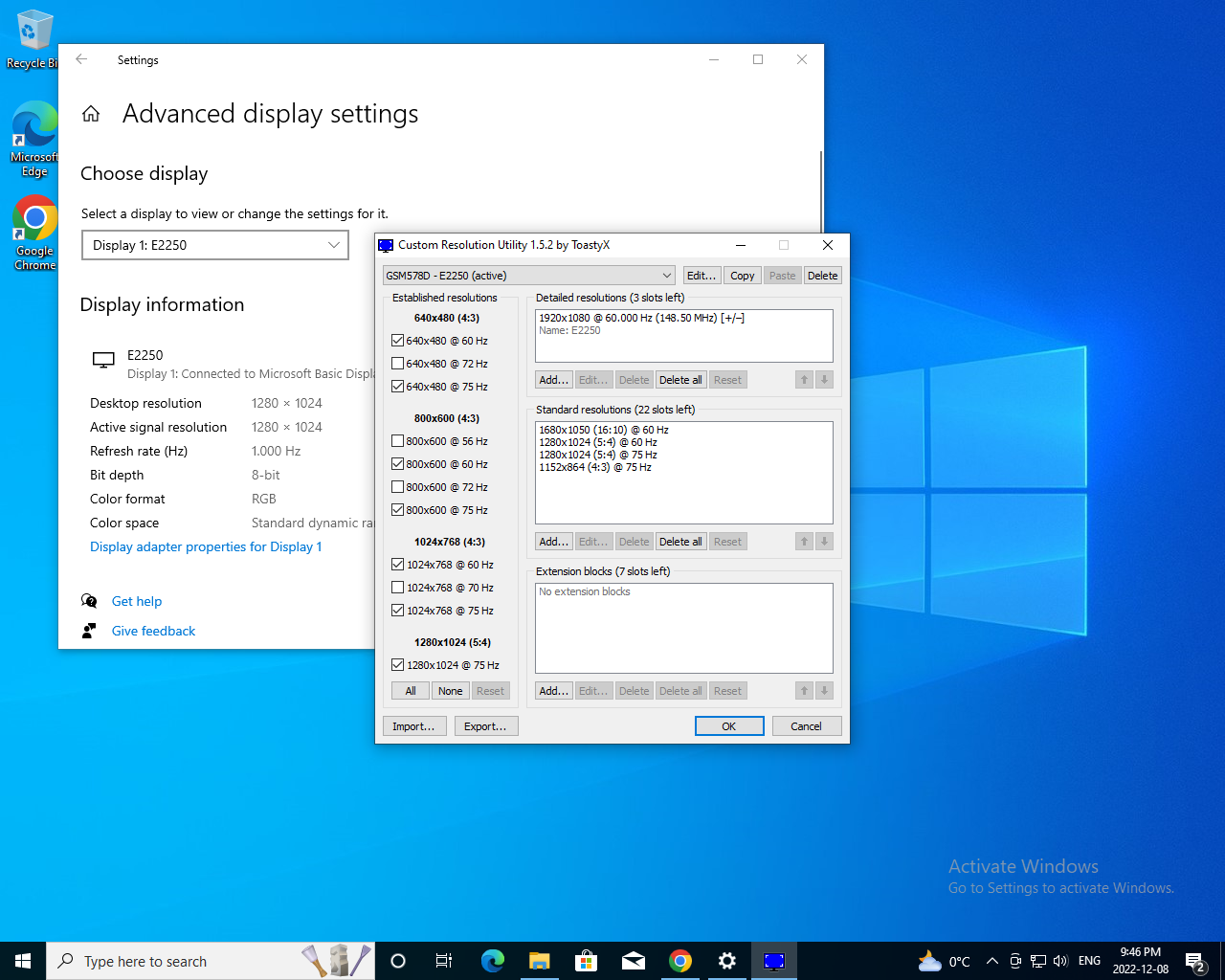

(12-07-2022 04:29 AM)Carnage6 Wrote:  Hello. I must be doing something wrong because I can't get this to work. I have an LG monitor. I installed Windows 10 fresh on an old computer running an old Geforce GTX470 card.
Windows recognizes my monitor as LGE2250 however it only lets me have 1280X1024 as my maximum resolution when the max for this monitor is 1920X1080 60hz.
When I use this application it shows the correct resolution as the detailed resolution (1920X1080 60hz).
When I click OK and run the restart program it doesn't change the resolution and when I go into display settings the LG profile is not recognized anymore and is replaced by "Display 1: Wired Display" now and the resolution is greyed out and I can't change it at all anymore.
When I go back into this program it now shows two monitor profile choices (the LG and "generic non-pnp" monitor.
What am I doing wrong?
Also, I tried updating my graphics card and when I try to download the latest driver it bricks my system so I gave up on that. Same if I try to update with Windows Update.
Also, downloaded the supposed latest driver from the LG website but none of the files seem to be an actual update that I can execute.
Like I said, I'm sure I'm doing something wrong but I have no idea what. Any help?

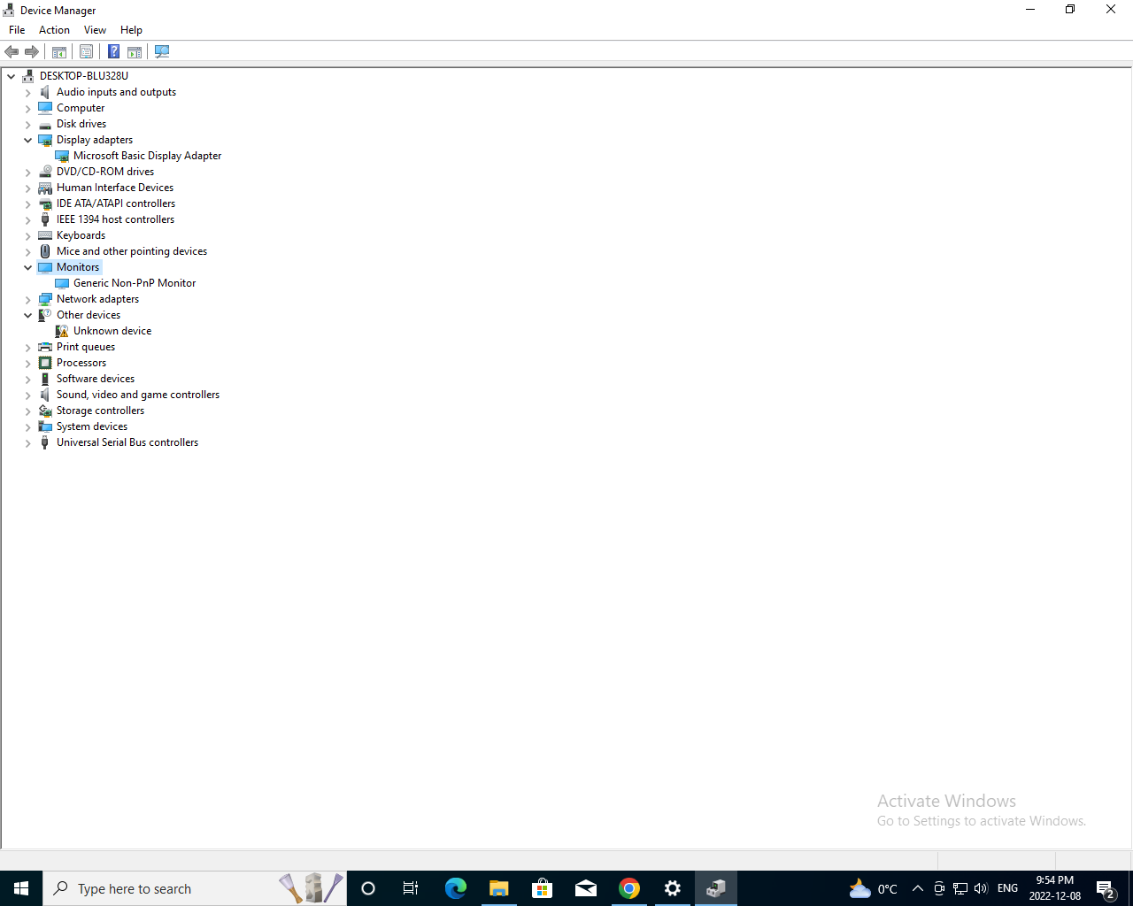

Post a screen shot of Device Manager that shows what's under display adapters and monitors.
I added before and after using the program.

(12-09-2022 02:57 AM)Carnage6 Wrote:  I added before and after using the program.
You need to install NVIDIA's driver for CRU to work and to get the correct resolutions, and "Generic Non-PnP Monitor" usually means there's a problem with the EDID, possibly because some bits got corrupted in the EEPROM, which can happen sometimes with older monitors.
When you say installing NVIDIA's driver bricks the system, do you mean the system won't boot, or do you mean the monitor won't display anything? If it boots but the monitor won't display anything with the driver installed, the EDID might be invalid. If that's the case, the easiest workaround is to use a different port on the monitor because that will have a different EDID.
Well even if I cut out all the extras and just choose to install the drivers this happens. After the first time the monitor flashes to black during the install Windows comes up with a message saying "Windows encountered a problem and needs to close". Then Windows repairs itself and if I try to install again same problem. Never ending loop.

(12-10-2022 02:05 PM)Carnage6 Wrote:  Well even if I cut out all the extras and just choose to install the drivers this happens. After the first time the monitor flashes to black during the install Windows comes up with a message saying "Windows encountered a problem and needs to close". Then Windows repairs itself and if I try to install again same problem. Never ending loop.
Also, here is the link to my monitor driver software which doesn't seem to actually have an executable program in it:
https://www.lg.com/us/support/product/lg-E2250V-SN.AUS
Then the video card is defective, or the driver is choking on a broken EDID. You shouldn't need to do anything special to get the monitor to work other than installing NVIDIA's driver, and if you can't install the driver, that often indicates a hardware problem. You don't need LG's monitor driver to get the correct resolutions.
