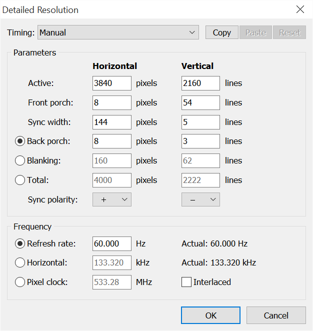

I am trying to limit my display resolution horizontally. What I am after is the native resolution with black bars on the left and right.
When I use CRU, Windows 10 (I also tried it in 8.1 with the same result) stretches the display instead of providing the desired horizontal letterbox.
Is there a combination of CRU settings that would allow me to achieve that?
Setup: Radeon R9 380, Wasabi Mango UHD420 (Korean 42" 4k monitor)
