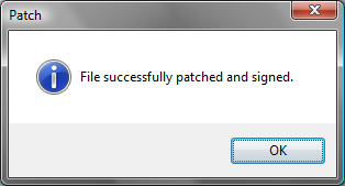

12-15-2015, 09:32 PM (Last edited: 12-15-2015, 10:21 PM by sanmal)
Post: #1859
Hello, i am back Angel
1. DVI connected.
2. Patched (screens attached).
3.
standard-> 1920x1080 @ 75.002 Hz (174.57 MHz) [+/-] ->Input not supported
native-> 1920x1080 @ 75.002 Hz (185.63 MHz) [+/+] ->Input not supported
reduced-> 1920x1080 @ 75.001 Hz (164.61 MHz) [+/+]
with users resolution same thing:
CVT-RB-> 1920x1080 @ 75 Hz (174.57 MHz(standard?)) ->Input not supported
Auto -> 1920x1080 @ 75 Hz (?(native?)) ->Input not supported
8800GT/Vista 32
Patch or something else not work for me, any chance fix it?
12-16-2015, 03:15 PM
Post: #1860
(12-15-2015 09:32 PM)sanmal Wrote:  standard-> 1920x1080 @ 75.002 Hz (174.57 MHz) [+/-] ->Input not supported
8800GT/Vista 32
The monitor might not support 1920x1080 @ 75 Hz with DVI. The patch is for driver limits, not monitor limits.
