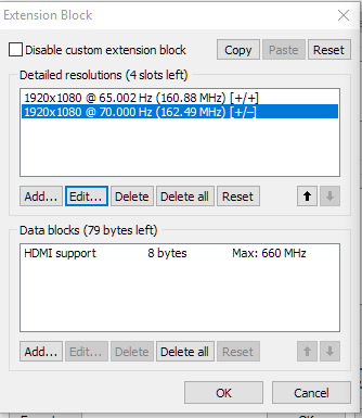

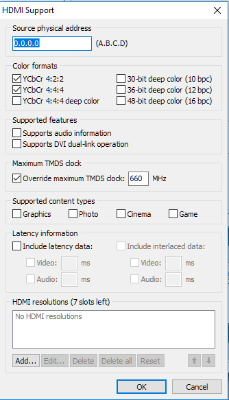

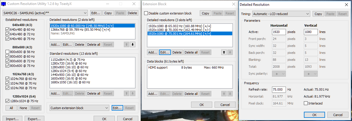

Hello ToastyX,
i tested 67Hz resolution on the ufo site and everything seems fine.
I always tested the custom extention block, hdmi data and the "LCD reducted"
option. Now i stay at 70Hz and ufo test is ok Smile but more didn't work.
When i reopen the detailed resolution, the timing is set back to manual?
I make some screenshoots from my setup, maybe you can see an error.
Thank you!
Beaverking

(09-17-2016 07:52 PM)Beaverking Wrote:  i tested 67Hz resolution on the ufo site and everything seems fine.
Did you check with a camera? Is the mouse movement smoother? If it skips frames, there should be visible stuttering.
(09-17-2016 07:52 PM)Beaverking Wrote:  I always tested the custom extention block, hdmi data and the "LCD reducted"
Have you tried the other timing options? If "LCD standard" and "LCD native" don't work, then the TV probably can't handle higher refresh rates.
(09-17-2016 07:52 PM)Beaverking Wrote:  When i reopen the detailed resolution, the timing is set back to manual?
The dialog always opens in manual mode. The timing options are there to help you fill in the values.
(09-17-2016 07:52 PM)Beaverking Wrote:  I make some screenshoots from my setup, maybe you can see an error.
I don't see any issues. It's probably just the TV.
