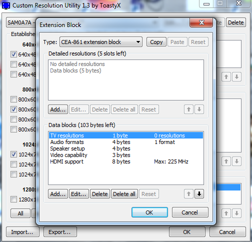

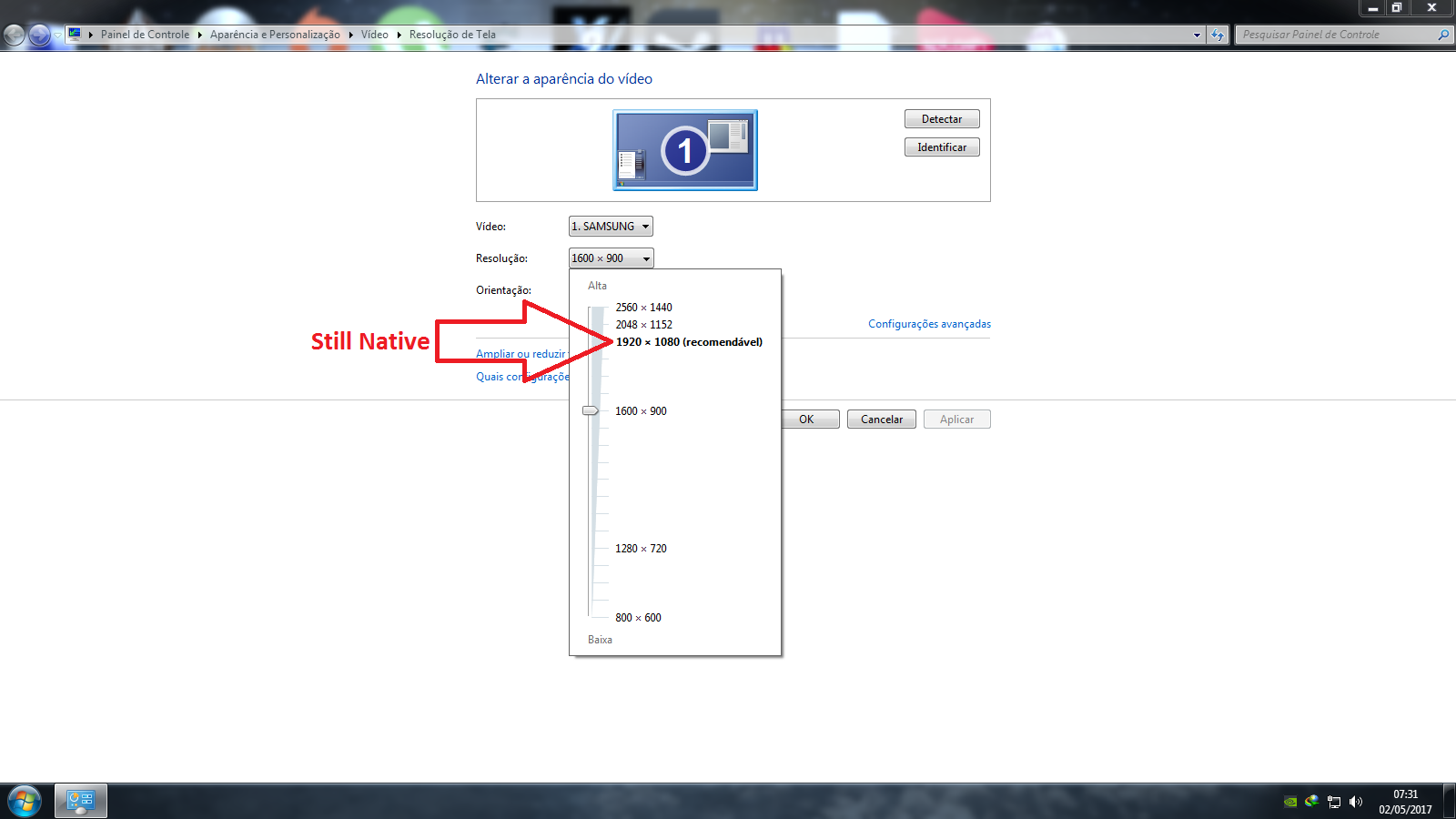

05-02-2017, 10:38 AM (Last edited: 05-02-2017, 11:04 AM by CeLioCiBR)
Post: #2802
(05-01-2017 09:00 PM)ToastyX Wrote:
(05-01-2017 08:18 PM)CeLioCiBR Wrote:  anyone here can tell me, how to change my native resolution ?
basically.. i want to change my native resolution, from 1920x1080
to 1600x900
The first detailed resolution is the native resolution. Just edit the first detailed resolution or add a new one and use the arrow buttons to move it to the top. Use the "LCD standard" timing option to fill in the values.
hello there xD
It din't work..
maybe i did something wrong ?
here.. the native resolution is still 1920x1080
i use a tv, it's not a monitor.. idk but, maybe that make's a diference ?
Samsung 39ยบ LED
Model Number: UN39FH5205GXZD
i use HDMI.. ^^
The reset-all.exe
it will just revert any change i made in the CRU, right ? ^^

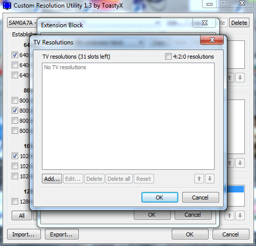

(05-02-2017 10:38 AM)CeLioCiBR Wrote:  hello there xD
It din't work..
That's strange. Edit the extension block and if there's a TV resolutions data block, edit it. If any resolution is listed in bold, edit it and uncheck the "Native format" option.
(05-02-2017 10:38 AM)CeLioCiBR Wrote:  The reset-all.exe
Yes.

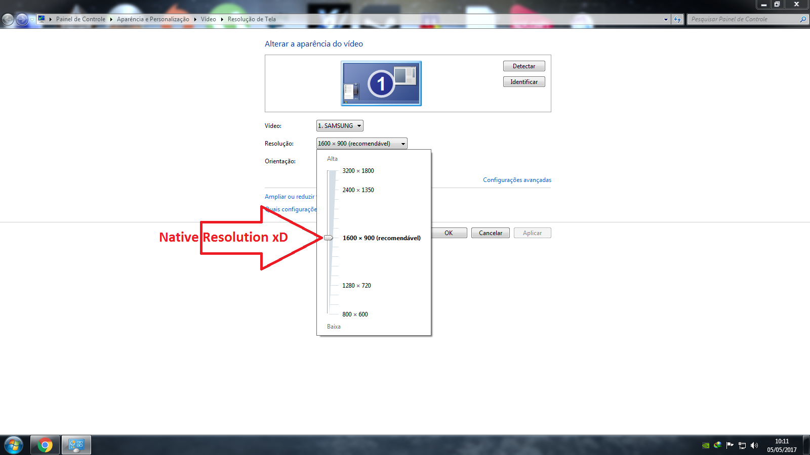

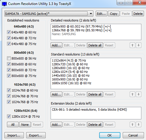

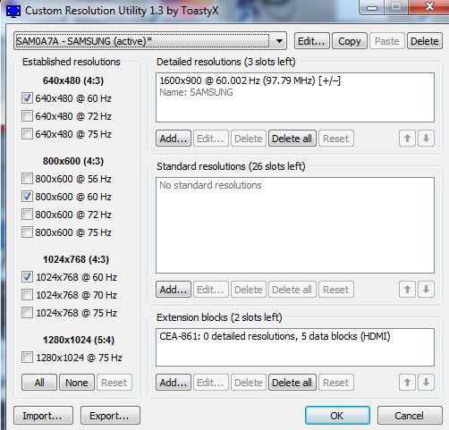

It din't work..
Yes.
Hello there, thank you very much.. it worked xD
here's the screenshots..
i deleted all resolutions i find.. i hope i not did something wrong xD
Thank's xD

(05-05-2017 01:15 PM)CeLioCiBR Wrote:  Hello there, thank you very much.. it worked xD
Thank's xD
You can delete the TV resolutions data block if you don't need any of the resolutions.
