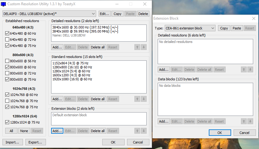

08-27-2017, 02:56 PM (Last edited: 08-27-2017, 02:57 PM by okwei)
Post: #3110
(08-27-2017 03:58 AM)ToastyX Wrote:
(08-27-2017 02:15 AM)okwei Wrote:  I have the intel HD 530. I try to force a 3840x1600 30HZ resolution since that's what the HDMI1.4 port support on my laptop. Resolution works fine except I had to either do the restart, or re-plug the HDMI cable.. Is this really a graphic card driver bug?
Yes, but there might be a workaround. What monitor is this? Is there a "Default extension block" in the extension block list?
it's the new dell 38" U3818dw. Extension block? I got the folowing
