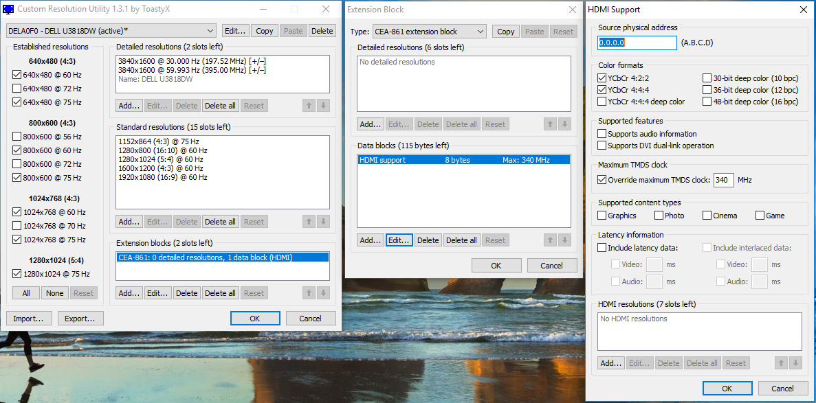

(08-27-2017 02:56 PM)okwei Wrote:  it's the new dell 38" U3818dw. Extension block? I got the folowing
Try importing the hdmi.dat file. Then reboot and see if that works around the problem.

So I imported the dat file (below), it worked only the first time I rebooted my PC.. then it's having the exactly the same issue - reboot/sleep/wake will reset my resolution to 2560x1600. What's this .dat file for? I also tried to play with extension blocks, but I have no clue what to enter..

The .dat file simply includes an extension block with HDMI support. The default extension block should already have HDMI support, but CRU can't read extension blocks with Intel GPUs. I was just checking to see if manually overriding it would work around the problem. You can change the type back to "Default extension block" to use the monitor's default extension block.

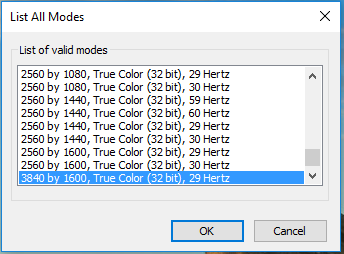

Correct. When the PC wakes up, there's no 3840x1600 available. And also not in the adapter's 'List All modes' list. (btw, it listed 29Hz, but i entered 30Hz in the setup, not sure why is that).

(08-28-2017 01:20 PM)okwei Wrote:  Correct. When the PC wakes up, there's no 3840x1600 available. And also not in the adapter's 'List All modes' list. (btw, it listed 29Hz, but i entered 30Hz in the setup, not sure why is that).
You said 3840x1600 is not available, but then you say 29 Hz is available. Does it stick if you choose 29 Hz? Is 30 Hz available after running restart.exe? If you can't use 60 Hz regardless, try deleting the 59.993 Hz resolution and see if that works around the problem.

What doesn't work with hdmi.dat? You said it did work the first time, and then you had the same issue as before. What you showed me should be enough to get 3840x1600 @ 30 Hz working with HDMI. As I said, CRU can't read extension blocks with Intel GPUs, but the default extension block should include HDMI support.

(08-28-2017 06:54 PM)ToastyX Wrote:  You said 3840x1600 is not available, but then you say 29 Hz is available. Does it stick if you choose 29 Hz? Is 30 Hz available after running restart.exe? If you can't use 60 Hz regardless, try deleting the 59.993 Hz resolution and see if that works around the problem.
29Hz is not available either. 29/30 either both show up or neither does. I tried both 29/30Hz, they dont work. want I dont understand was why I enter 30Hz in the tool, but 29Hz also shows up in the 'mode list'. I also tried deleting the 59.9Hz, doesn't work either. I guess, i probably will give up.. just restart my video card each time i restart the PC - Or I guess I need a new laptop to match up with the new monitor.

(08-29-2017 01:52 AM)okwei Wrote:  29Hz is not available either. 29/30 either both show up or neither does. I tried both 29/30Hz, they dont work. want I dont understand was why I enter 30Hz in the tool, but 29Hz also shows up in the 'mode list'.
Microsoft wants refresh rates like 29 Hz to exist for TV resolutions, so it's automatically added by the graphics driver: https://support.microsoft.com/en-us/help...ted-settin
