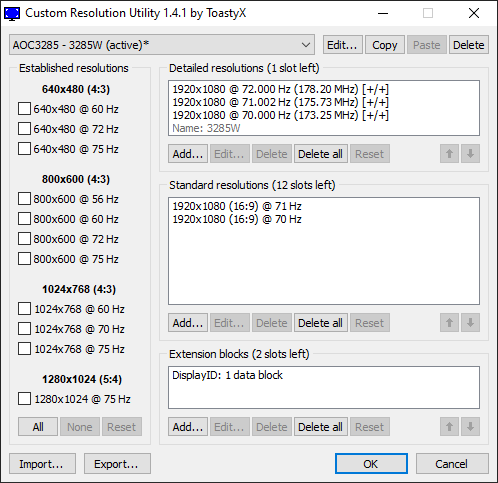

I used this tool before and managed to put in a custom refreshrate for my AOC monitor which worked perfectly. I had to refresh Windows and after the refresh I just can't seem to add any new resolutions or refreshrates! I'm pretty sure i did it in the right way but maybe the last windows version is causing some issues?
I'm trying to modify the refreshrate for my second monitor plugged into the laptop's HDMI port. it's an AOC M3285 monitor and it does 70 or 71Hz overclocked.
I added the new refreshrates and even deleted the old ones but it just won't show up in windows settings.....
I have the monitor setup as second display only as main monitor. it handles a different scaling than the internal display. I can see that. It's not duplicated.
Anyone any idea whats going on?
Got it sorted!
needed to add the resolution as LCD standard and not LCD native

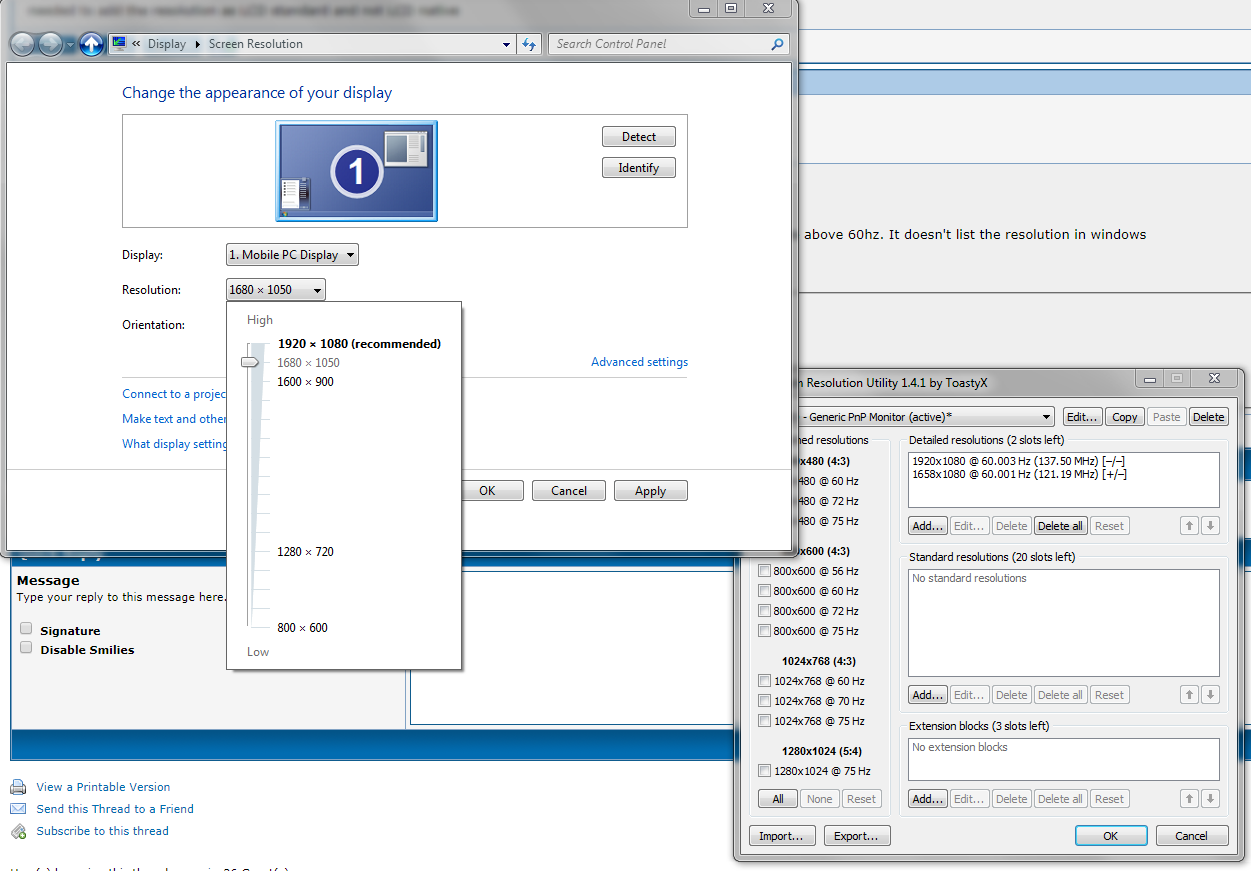

I have a clevo laptop with HD 4600 and GTX 870m, windows 7
When I try to use CRU (using the driver you linked for intel hd) I can't make custom resolution or set the refresh rate above 60hz. It doesn't list the resolution in windows
