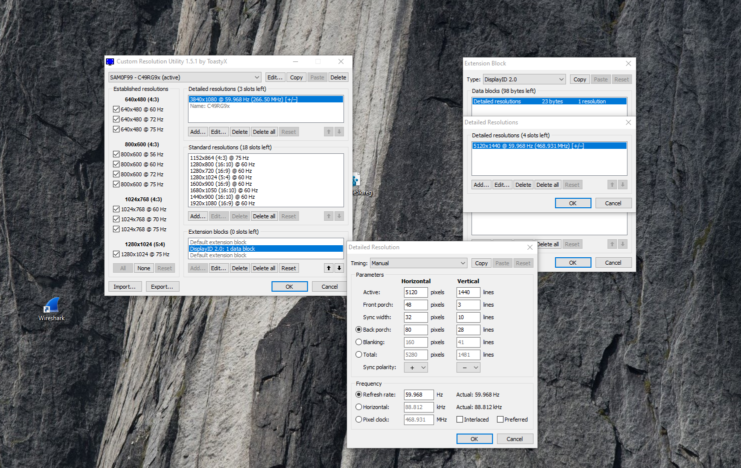

Hello Gals and pals,
Maybe this question was answered before, but I'm in big troubles here. I've been receiving a laptop from my work (Lenovo T14 Gen 1) and I have a C49RG90. I used to have it with my old company's computer, and it worked fucking well. Now of course with the T14 and it's built-in Intel UHD620 it's not working. No resolutions are correct, everything is pixelated. With Intel Graphic cards utility I can add a custom resolution of 5120x1440@30hz, but then the image is not well at all. I've seen some people managing to get that screen working correctly, I tried using CRU.exe but the resolution does not appear. When I try to edit either the Detailed or standard resolutions, it does not allow me to add a 5120x1440 (going red). When I use the extension bloc (either 1.3 or 2.0) the resolution will never appear in the windows menus. any ideas if what's i'm trying to do is possible ? |
