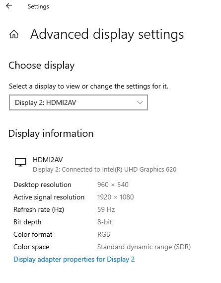

(03-02-2023 04:32 AM)ToastyX Wrote:
(03-01-2023 08:07 AM)bobo Wrote:  Hi Toasty.
Am using CRU to set a custom resolution on my old crt tv. Using an hdmi to av converter(DISPLAY ID:LTM0000) from my laptop with an intel igpu.
when I set the resolution and switch to it the text is a bit faded and the image gets blurry. I tried all the timings and tried copying the default timing and just modifying the resolution but it all has the same effect.
The only way to get it to display correctly is setting a high refresh rate then choosing the default one in the display settings. now I can live with that but some games opt in for the higher refresh rate with no way of changing it which also has frame skipping and the blurriness.
Thanks in advance.
The only reasons it would be blurry are if there is scaling or some kind of conversion going on. Keep in mind HDMI supports both YCbCr and RGB, which also has limited and full range, so changing that could affect the image. What adapter are you using? What resolutions and refresh rates are you trying to set?
No scaling is applied not sure about conversion.
I tried the setting (RGB,full) in the intel GCC and it made a tad bit better but not the full quality am getting with setting it like the attached image.
Adapter: https://www.amazon.com/dp/B071L4JWWB/?tag=mtests-20#ad
Resolution: 960*540@60 although it happens with any custom set resolution.
