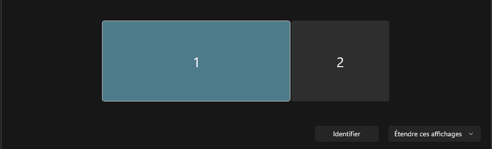

(02-16-2023 02:40 AM)Neobioz Wrote:  Hello @ToastyX ! I have a Samsung G9 Odissey screen I use it with the PBP function which gives me two screens. They are connected to an MSI RTX 4080 Supprim X with Windows 11. Unfortunately my display port 1 is detected as screen 2 and vice versa for display port 2 by Windows. Before I had an RTX 2080 and when I had the problem with this same screen, I used your software (RESET ALL) to redefine the identification of the monitor but since I am on the RTX 4080 impossible to make the change identification. Do you have a solution please or is it necessary to update the CRU software ? Thank you for your answer and sorry for my approximate English I am French.
You can set the main screen in the Windows display settings. CRU doesn't have control over that.
Thank you for your reply. Defining the main screen in the settings does not change the identification it just puts my screen identified in 2 as the main screen. This is not my goal but to modify the identifications. It does not matter, thank you anyway, but I ended up plugging my 2nd display port into my motherboard and I have the correct identifications.
For information, the .exe called RESET ALL really allowed me to change these identifications when I had my 2080, why I don't know. Thanks again and good luck for the future.

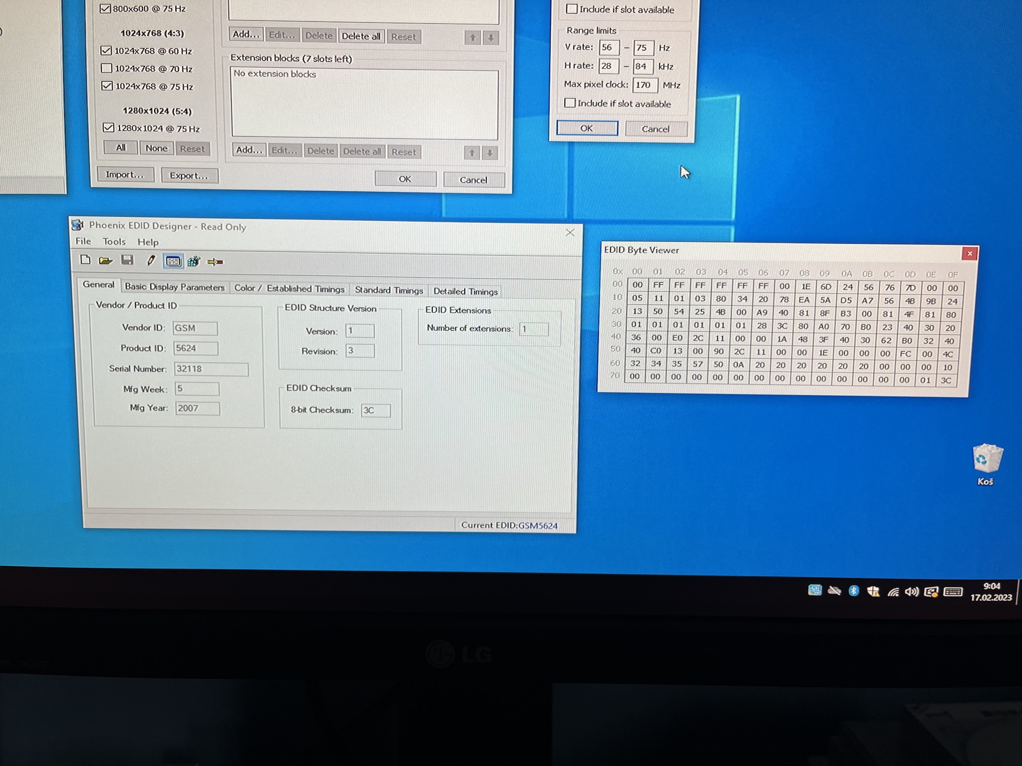

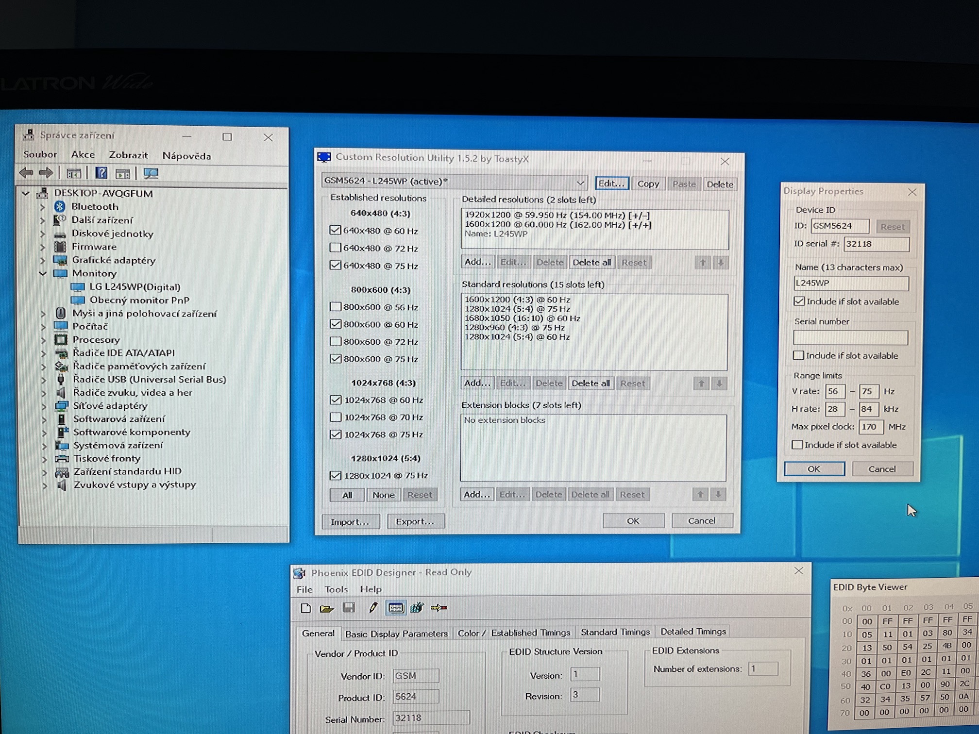

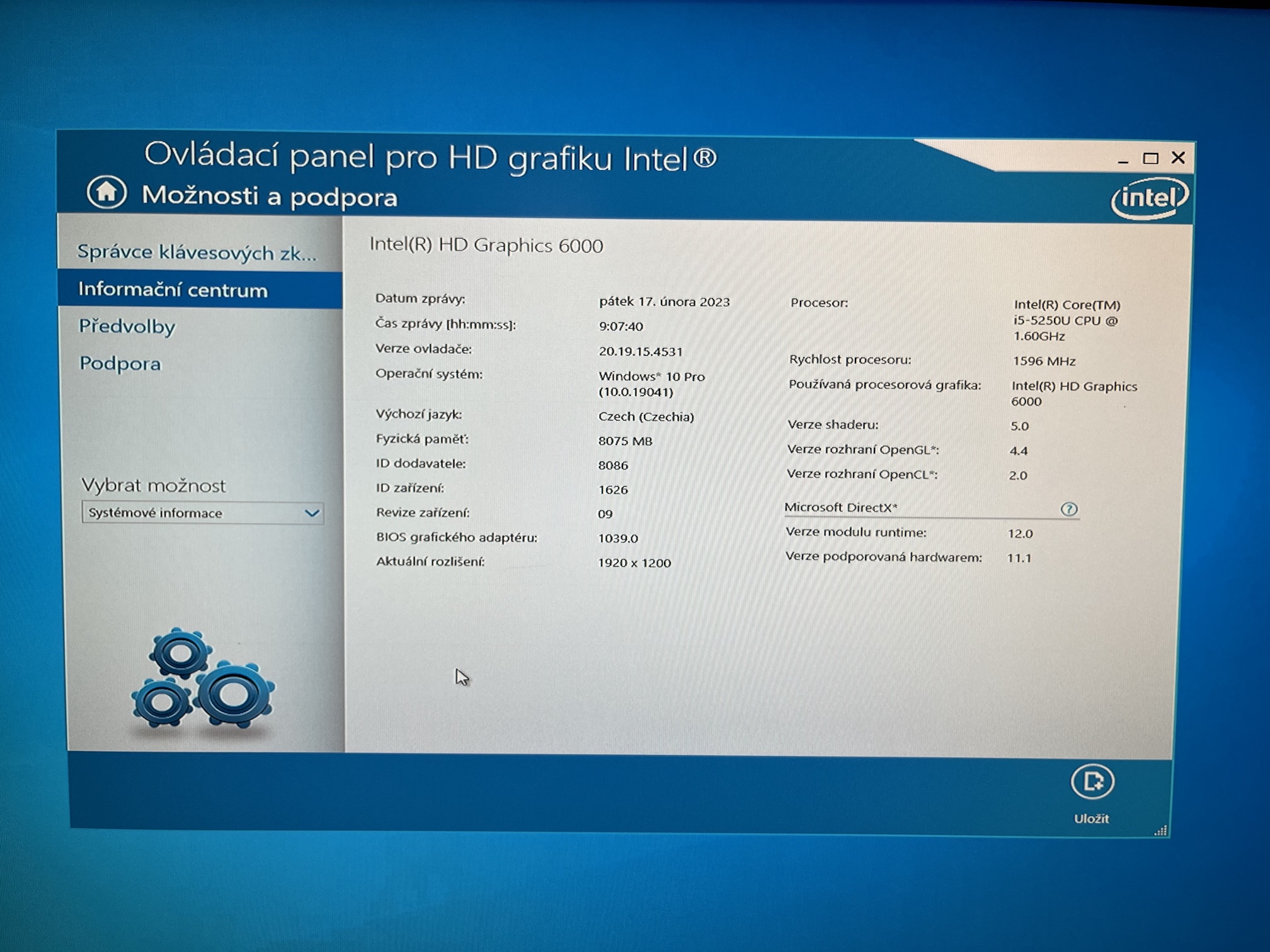

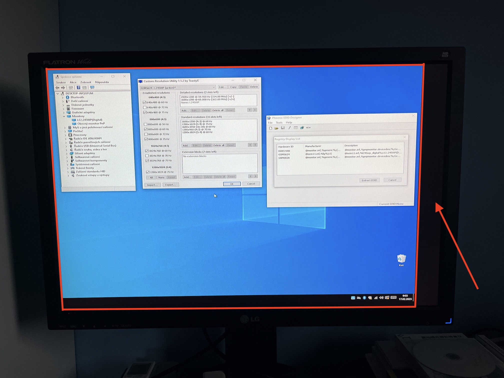

I just found out this great utility and I would like to ask you about some help as I don't know where to find the solution Confused
Display:
- LG L245WP-BN (official LG drivers installed) connected to my miniPC via HDMI cable
PC:
- Intel NUC (CPU: i5-5250/8GB RAM/GPU: Intel HD Graphics 6000) with 64bit Windows 10 Pro
I was trying to connect this old display to my miniPC but the whole screen is cropped/shifted as can be seen at attached photos.
I was trying to check and overwrite the EDID of the display (EDID dumped via Phoenix EDID Designer) but as far as I know these problems are usually connected to NVIDIA GPUs. Anyway, I checked the EDID of the display in registry (regedit) but the table is very the same as the result from Phoenix EDID so there was nothing to change.
When I launch the CRU, there are also no other extension slots that could be deleted.
Do you have any idea how to solve this problem? I don't want to throw the display in the trash as it is basically OK Undecided

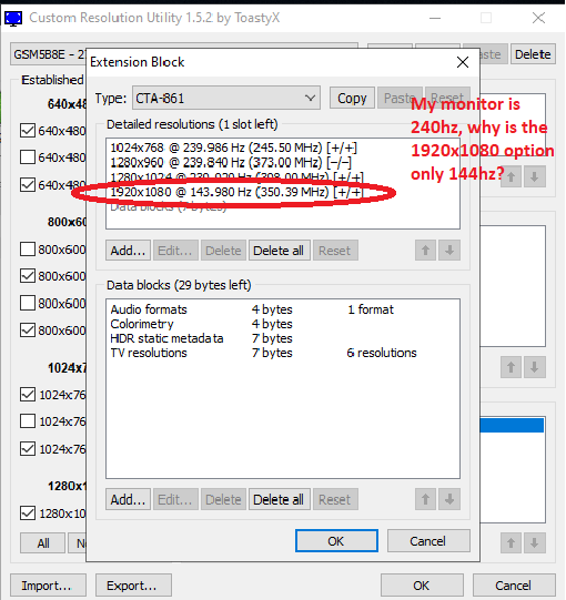

Hi @ToastyX, I have a few concerns and issues. I have a LG27GN7 240hz monitor, and I am trying to get a resolution of 1720x1080 using CRU.
To begin, when I try to edit my extension block timings the only 1920x1080 option is 144hz when my monitor is 240hz. There is no 240hz option so naturally, I manually changed the hertz to 240 after pressing edit on the detailed resolution of 1920x1080 @143.980 Hz (I have included an image). I am confused as to why I did not have a 1920x1080 @240hz option come up for me.
After copying the timings, deleting all standard resolutions and creating a new one at 1920x1080 @60HZ and pasting the timings into a new detailed resolution, where I had to change the hertz to 240hz from 143.980hz again. I run restart64, and put on the 1720x1080 @240hz res on from the list mode in windows.
After putting on this new res I created, I get a black vertical bar going down the middle of my screen and I have no clue why. I do not know if it is because I had edited the hertz of the resolution in CRU to 240hz when it was originally 140hz even though my monitor is 240hz.
Please help me, I don't know why I am getting a black bar in the middle of my screen

(02-20-2023 02:49 AM)Elias Wrote:  Hi @ToastyX, I have a few concerns and issues. I have a LG27GN7 240hz monitor, and I am trying to get a resolution of 1720x1080 using CRU.
Thank you.
You're not showing the whole thing. 240 Hz exists somewhere. I looked up the EDID for this monitor, and it has 1920x1080 @ 240 Hz as the first detailed resolution in the main window. You don't need to add it again. You can just add 1720x1080 @ 240 Hz. If the monitor can't display that correctly, then you'll have to use GPU scaling.
