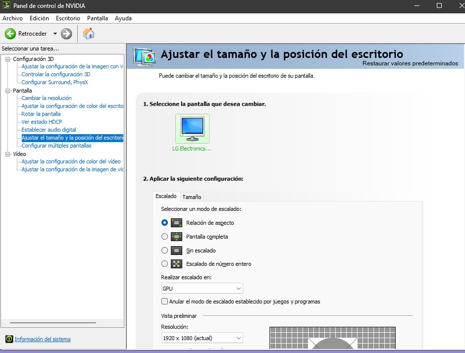

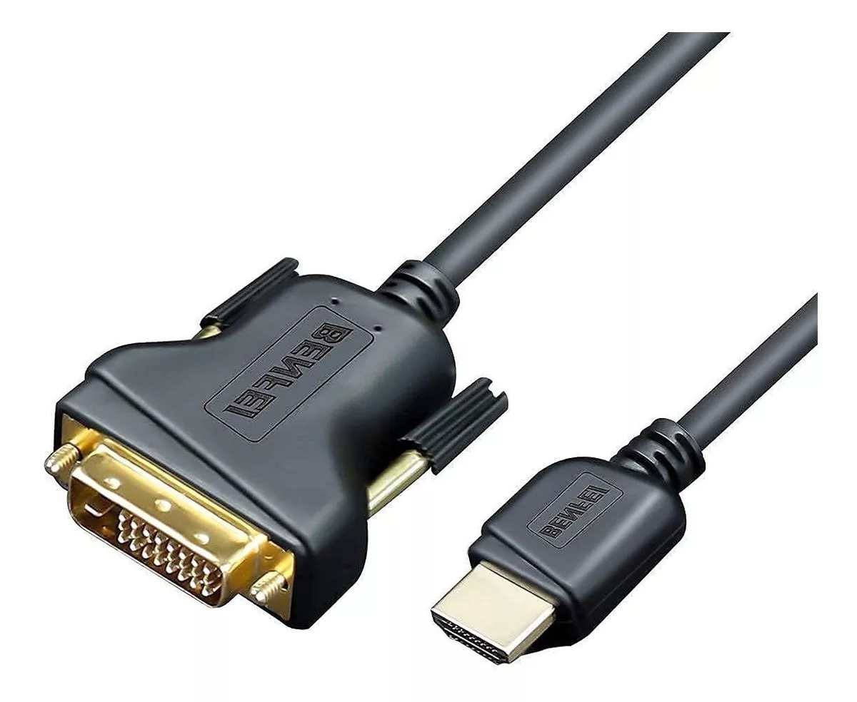

Hello all!
Just bought this cable for my LG W2363D
These are my options
Im usually able to switch to 120hz but now with this cable i dont have that option and when i use CRU doesnt work as i remember.
Been using hdmi cable dont know of what quality but it worked at 120hz
I had to switch the dvi port because the monitor is old and fell couple times so went back to good old dvi that i remember it worked with my 1080ti (Dvi to dvi)
Now im using laptop with 3050ti dedicated and it has only one hdmi port
I had it running as ive said but hdmi to hdmi (broke the cable trying to use it to the last breaths of the monitors hdmi ports lifespan hahah)
Now im stuck to 60hz and its driving me crazy headaches and all i happen to have very good astronaut like eyesight but i guess its too sensitive sometimes.
Please help! I will reward because the monitor works great for being 10 years old!
Thanks in advance!
ps: for any extra info or screenshot just ask
EDIT: windows 11

You need dual-link DVI to get 120 Hz. HDMI-DVI adapters/cables are always single-link. There's no way to convert HDMI to dual-link DVI. Adding an HDMI data block in the extension block will make the GPU send an HDMI signal, which should allow you to select 120 Hz, but the monitor might not accept a single-link signal on the DVI port. You'll have to try it and see. Some monitors will display it with a warning message, but some monitors won't let you dismiss the warning message.
