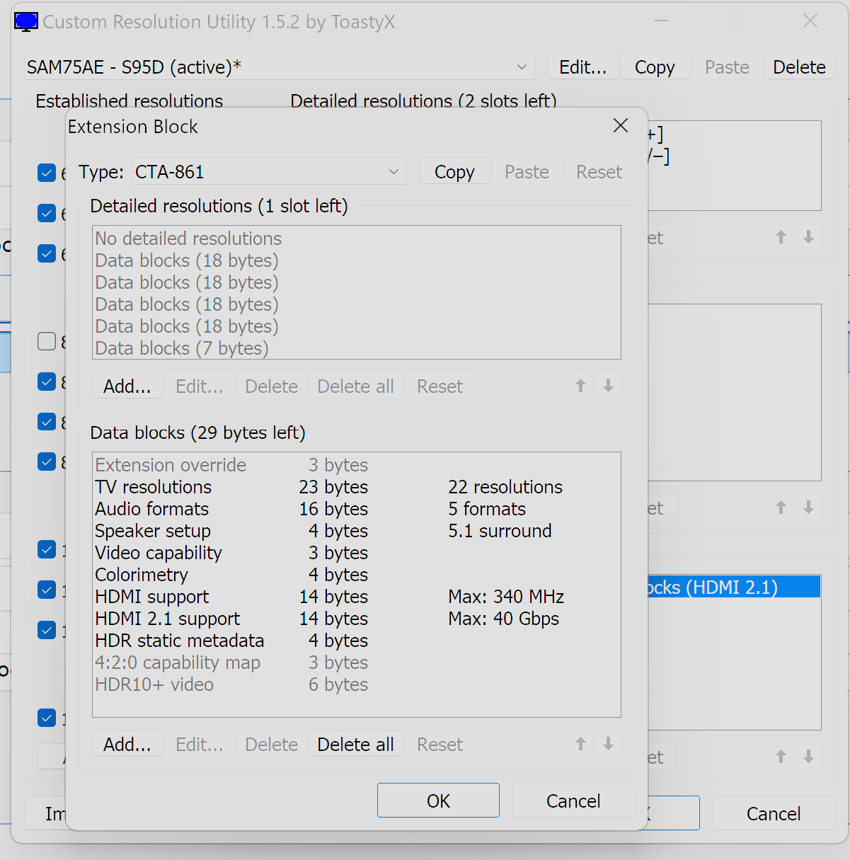

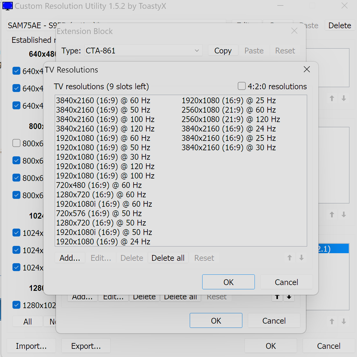

Hi @ToastyX. Thanks for years of amazing fixes via CRU... indispensable!
I always use CRU to remove the 4096x2106 resolution from my TV's, as I find it can cause issues when launching some games for the first time on my PC. I've just upgraded for a Samsung S95B QDOLED to a Samsung S95D QDOLED and I am finding that my regular CRU fix methodology is not working. Games are still showing the 4096 resolution, as is NVCP?? Steps followed are editing the CTA-861 Extensions Block as follows: 1 Remove all 4096x2160 resolutions from 'TV RESOLUTIONS' (there were 6x) 2. Remove all 4096x2160 resolutions from 'HDMI SUPPORT' (there was 1x) Looking at the how to (and some earlier posts here), there is reference to removing the resolution from the '4.2.0' Block also. Whilst I've never had to do this before, happy to do so, however the only block I have with a similar naming convention is '4.2.0 CAPABILITY MAP', but that is greyed out? Have tried multiple reboots, restarts and resets, but that pesky resolution remains available in Windows 11 for some reason!? Have added a screenshot below... would appreciate any advice. Thanks ![]() |

(04-20-2024 06:14 PM)Scoobyroo Wrote: Hi @ToastyX. Thanks for years of amazing fixes via CRU... indispensable!Is there another extension block? I need to see everything. Run this and post the test.txt here: https://www.monitortests.com/EDID-test.zip |
