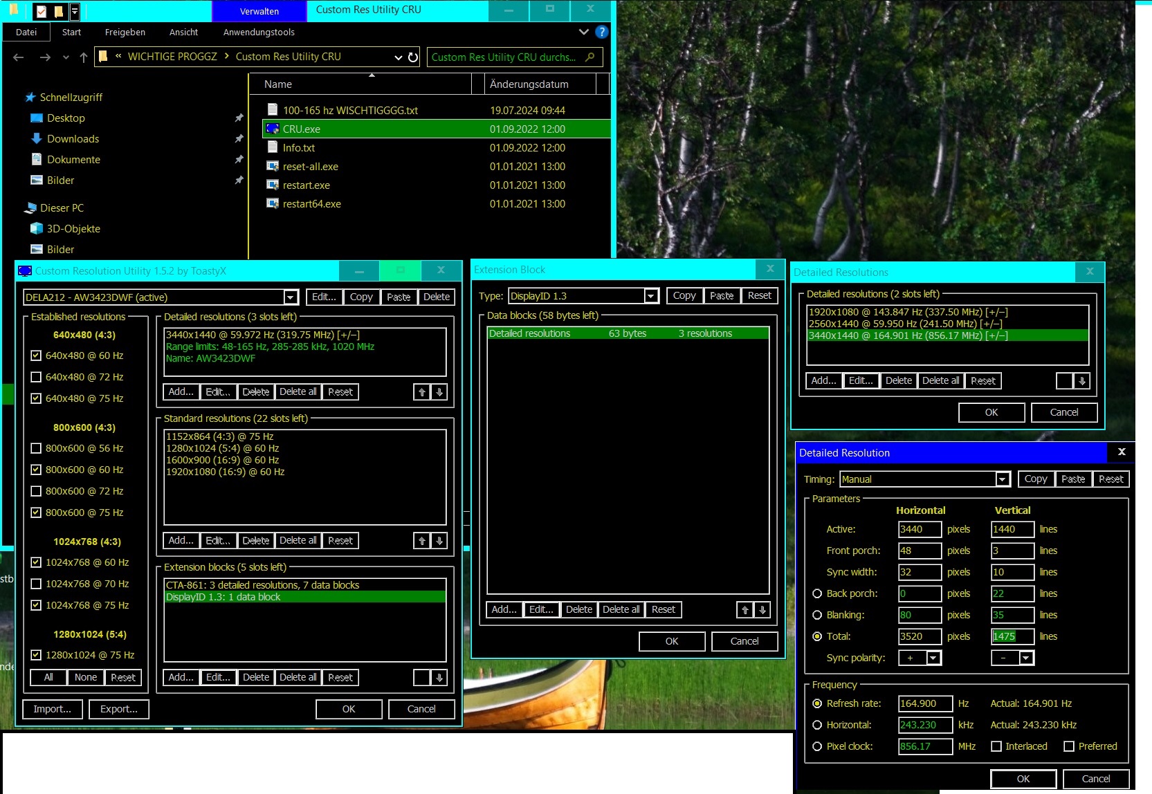

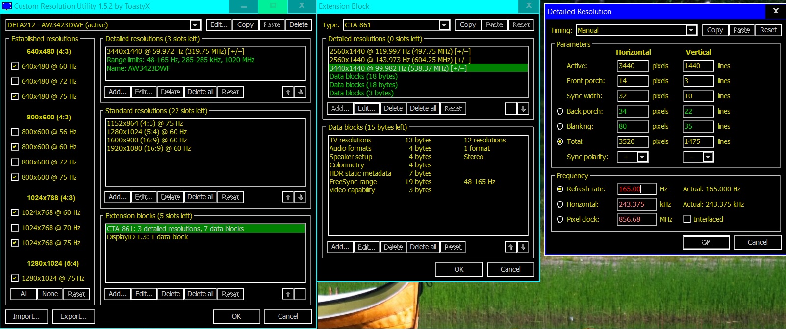

Ok, i edited displayid 1.3 and got blackscreen again. On cta-861 i cant enable it becaus pixelclock turns red.
04-12-2025, 09:25 PM
Post: #9038
(04-12-2025 09:07 PM)ildottore101 Wrote:  Ok, i edited displayid 1.3 and got blackscreen again. On cta-861 i cant enable it becaus pixelclock turns red.
That is supposed to work if the monitor supports the timing. Do you have any other monitors connected?
