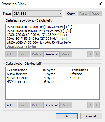

(06-23-2020 07:41 AM)cyrb Wrote: The GPU is NVIDIA GeForce 840M (laptop GPU). The Windows 7 machine is NVIDIA GTX 1050 TiYou didn't say these were two separate computers. This is not a Windows 10 issue. You said the Windows 10 computer showed no extension blocks, but your screenshot shows a default extension block. That just means CRU can't read the extension block with your laptop. Copying the settings over from the other computer should have worked unless the driver doesn't support EDID overrides. Try deleting the extension block. |

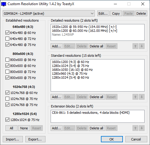

I've just upgraded my PC from Win 7 with old Gigabyte MoBo Intel Core quad and GPU nVidia Quadro 1500 to a new Win 10 x64 setup Intel i7, Asus ROG Stix Z390, RTX 2070 Super. I have a dual 24" monitor configuration (LG 24MB67 connected to DP + LG L245WP connected to HDMI) Both are configured in Window to display at 1920x1200 @ 59.950Hz The first monitor looks great! The second one, not too much... ![]() The desktop is stretched horizontally a bit and the entire desktop is shifted to the left for about 120 pixels and to the top for about 20-30 pixels. I tried to connect it to a different PC with a different HDMI cable but i got the same exact result. So the problem it is not related to GPU or cable i think. I heard about EDID information 2 days ago and i have understood the problem could be about corrupted info sent to GPU card from monitor. So i launched CRU but I'm a totally newbie at it. ![]() ![]() Is there an official manual for it? I really would like to know more about the gui sections and how them work. Anyway, having you here ToastyX, i kindly ask you to help me to fix the problem. I have attached 4 images about CRU (2 x monitor). I noticed the good displaying monitor has the native configuration 1920x1200 in the extension block, while the bad one not. Thanks a lot. Daniele |
06-24-2020, 02:15 PM
Post: #4877
(06-23-2020 10:15 PM)jdaniele Wrote: I heard about EDID information 2 days ago and i have understood the problem could be about corrupted info sent to GPU card from monitor.The L245WP has a bug with HDMI. Deleting the extension block will fix the problem. |

(06-24-2020 02:15 PM)ToastyX Wrote:(06-23-2020 10:15 PM)jdaniele Wrote: I heard about EDID information 2 days ago and i have understood the problem could be about corrupted info sent to GPU card from monitor.The L245WP has a bug with HDMI. Deleting the extension block will fix the problem. Hi ToastyX, you rock! I deleted the extension block, clicked ok and CRU closed itself. Then i used restart64.exe to restart the display driver but the LG went totally black. So, i tried to change the resolution to 1280x720 and it showed it but with two black band up and down, probably because the monitor aspect ratio is 16:10 and 1280x720 is 16:9. Then i changed back to 1920x1200 and finally i got what i wanted to see: the desktop displayed correctly on the entire screen. So it worked ToastyX, thanks a lot. The only strange thing is that now nVidia control panel now tells me that the monitor is connected to the DVI - PC port (that do not exists on RTX2070 super) and not anymore to HDMI. That's weird, isn't it? ![]() Anyway, your software is really useful and with your precious help if fixed my monitor! Thanks ![]() jdaniele |
06-24-2020, 05:58 PM
Post: #4879
(06-24-2020 05:48 PM)jdaniele Wrote: The only strange thing is that now nVidia control panel now tells me that the monitor is connected to the DVI - PC port (that do not exists on RTX2070 super) and not anymore to HDMI.No, it's not weird. It sends a DVI signal if there isn't an HDMI data block in the extension block. The LG monitor doesn't handle 1920x1200 correctly with an HDMI signal. |
