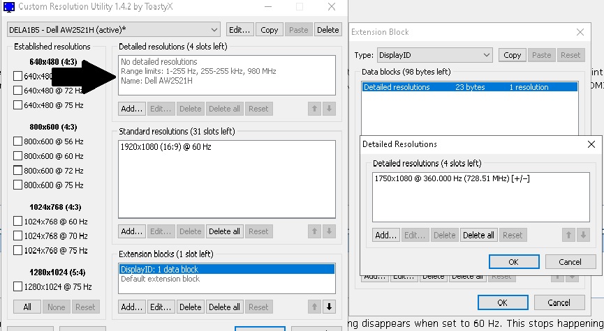

Hi I have AW2521H 360Hz monitor, but i cant add 360 hz option while adding detailed Resolution. Any thing 300 and above turns red and i cant add them.

(01-30-2022 12:06 AM)salman003 Wrote:  Hi I have AW2521H 360Hz monitor, but i cant add 360 hz option while adding detailed Resolution. Any thing 300 and above turns red and i cant add them.
You quoted the entire first post and didn't bother reading it. Also, the monitor already defines 360 Hz, so what are you trying to do?

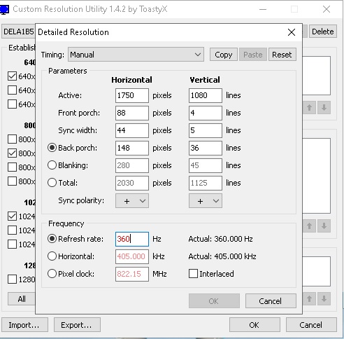

i am sorry but i am trying to create a custom 1750*1080 resolution on 360 hz.
https://www.youtube.com/watch?v=k5f3WDLG3K8&t=579s
once i put 360 hz its turn reds, see screen shots.
[Image: view.php?img=LPic61f62b4a667dc1617785718]
https://www.linkpicture.com/view.php?img...3563902428
Also i trioed to search the whole forum, there are many people who faced same problem onm 360 hz but no one posted any solution. thanks again.

(01-30-2022 02:29 PM)ToastyX Wrote:
(01-30-2022 06:09 AM)salman003 Wrote:  Also i trioed to search the whole forum, there are many people who faced same problem onm 360 hz but no one posted any solution. thanks again.
You still didn't read the post you quoted where I posted the solution.

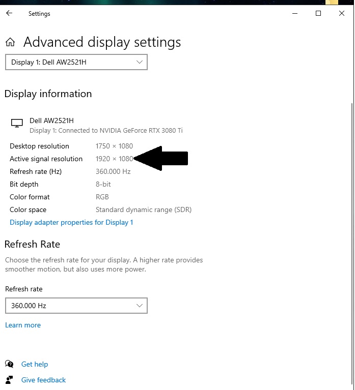

i am sorry again, I am not a gret tech guy, I added 360 hz in extension block as display id but how to put 360 in detailed resolution. i am getting small screen Black edges on 1750*1080 as active signal resolution is still 1920*1080.
Please help Sad
01-30-2022, 10:49 PM
Post: #6369
(01-30-2022 09:41 PM)salman003 Wrote:  i am sorry again, I am not a gret tech guy, I added 360 hz in extension block as display id but how to put 360 in detailed resolution. i am getting small screen Black edges on 1750*1080 as active signal resolution is still 1920*1080.
Please help Sad
What are you doing? You are overcomplicating things with extra steps, and you still didn't read the first post.
Run reset-all.exe and reboot. Then read this:
(09-07-2012 09:06 PM)ToastyX Wrote:  NVIDIA: CRU can only read the first extension block because the driver has a bug that prevents reading additional extension blocks. NVIDIA also does not support default extension blocks, so delete any default extension blocks and add one manually if needed. The second extension block is usually a DisplayID extension block with detailed resolutions greater than 655.35 MHz pixel clock such as 1920x1080 @ 360 Hz and 2560x1440 @ 165 Hz.
So delete the default extension block, add a DisplayID 1.3 extension block, and then add 1920x1080 @ 360 Hz (if you still want it) and 1750x1080 @ 360 Hz as detailed resolutions in the extension block. That's all you need to do.
