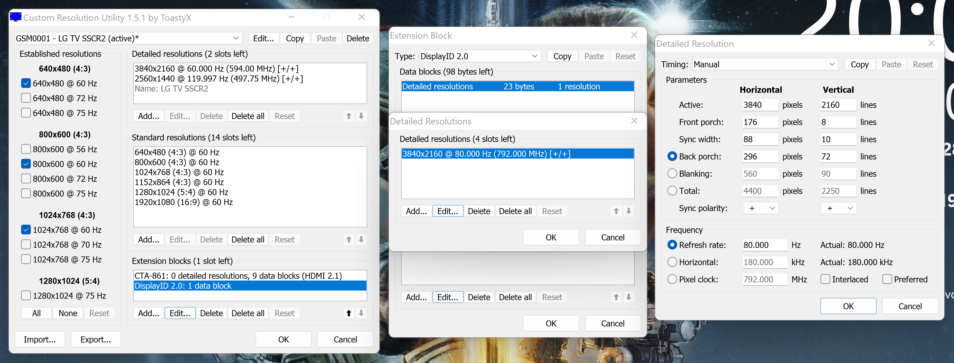

05-12-2022, 05:20 PM (Last edited: 05-12-2022, 05:23 PM by ZoRG172)
Post: #6579
ToastyX
Hello, thanks for your software. I have a TV 4K/120 Hz. I need to make a custom resolution like 3200x1800/80Hz. I used to just create it in the Nvidia control panel, or enable their scaling feature to add intermediate resolutions. But now, when such resolutions are enabled, the color signal becomes 4:2:2. In native 3840x2160 120Hz produces true 4:4:4. It started with all the latest nvidia drivers.
Using your Scaled Resolution Editor (SRE) utility, I created a custom resolution of 3200x1800 and it works with 4:4:4 chroma, but you can only select standard 60/100/120 Hz refresh rates, and I need 80Hz.
Through CRU, I added a resolution with the parameters from the screenshot via DisplayID 2.0, but it still goes into color 4.2.2. How to be? Can it be possible to replace the standard 100Hz refresh rate with 80Hz?
Screen
05-13-2022, 12:20 AM
Post: #6580
(05-12-2022 05:20 PM)ZoRG172 Wrote:  Through CRU, I added a resolution with the parameters from the screenshot via DisplayID 2.0, but it still goes into color 4.2.2. How to be? Can it be possible to replace the standard 100Hz refresh rate with 80Hz?
I don't see why that wouldn't work at 4:4:4 if the GPU supports HDMI 2.1. That sounds like a driver bug or some limitation. HDMI 2.1 displays normally use CTA-861 standard TV resolutions, so maybe there's some NVIDIA-specific issue with non-TV resolutions.
