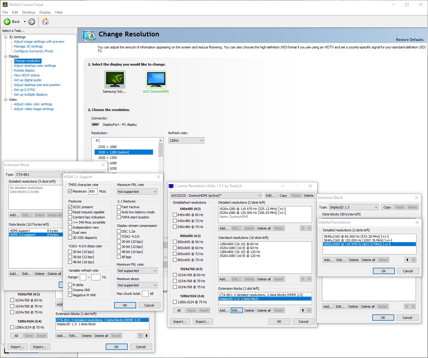

I'm having trouble adding 4K resolutions to an HDMI dummy plug I use for remote access.
Am I doing something wrong? Hopefully the attached picture has all the information.
Thank you!
09-01-2022, 06:11 PM
Post: #6865
(09-01-2022 03:30 PM)aelius Wrote:  I'm having trouble adding 4K resolutions to an HDMI dummy plug I use for remote access.
Dummy plugs are still bound by pixel clock limitations. Dummy plugs are usually HDMI 1.4 (340 MHz limit) or DisplayPort 1.0/1.1 HBR (360 MHz 8 bpc/480 MHz 6 bpc).
