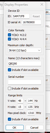

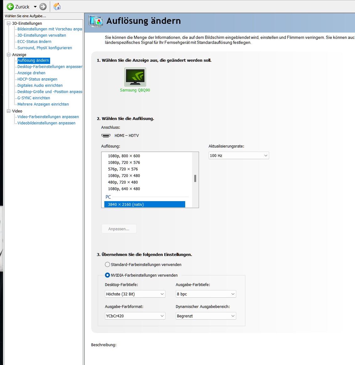

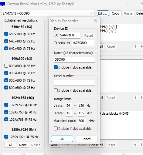

Hello all,
since I have now spent hours trying to solve the problem myself but unfortunately can not find a proper solution I turn to you.
Since yesterday I have upgraded my monitor from a Gigabyte M32U to a Samsung 43QN90B and unfortunately had to realize that in the Nvidia driver (latest installed yesterday) the DSR function is gone.
Since I play almost all single player games with DSR, this is a very important function for me.
Here are a few things that i tried.
Completely uninstalled the DDU driver and reinstalled the newest one - no success.
Old monitor (M32U) plugged in and DSR is directly available
On the new monitor/TV game mode on and off which did not help.
Then I can take the idea of the tool CRU with which you can overwrite various settings of the monitor.
But here I do not get on so right.
I had it once so run that I had DSR enabled again but then only 30/60hz at 4k could select in the Nvidia driver, 144 was no longer present.
I then reset everything and restarted so that I at least have restored 4K/144Hz.
So it is definitely the device itself and its identification to the RTX4090 or Windows 11.
Does anyone have ne idea how I can set up with the help of CRU that he 4K 144HZ 10/12bit and DSR enabled?
btw: On the HDMI 2.1 cable it does not work either, that runs on the M32U with DSR without problems in the cross test.
OR
Do you know another solution how to set higher resolutions with cru - without Nvidia driver?
I would like to have the 5120 (I think 1.78) and 5760 (2.25x) scaling again to be able to use DLSS.

(03-27-2023 02:16 PM)sebastian.f Wrote:  Does anyone have ne idea how I can set up with the help of CRU that he 4K 144HZ 10/12bit and DSR enabled?
NVIDIA does not currently support DSR with display stream compression (DSC). In theory, 3840x2160 @ 144 Hz at 8/10 bpc should be possible without DSC with HDMI 2.1 at 48 Gbps, but not with DisplayPort. Were you using DisplayPort or HDMI with the M32U? Export a file for each monitor using CRU and post them here.

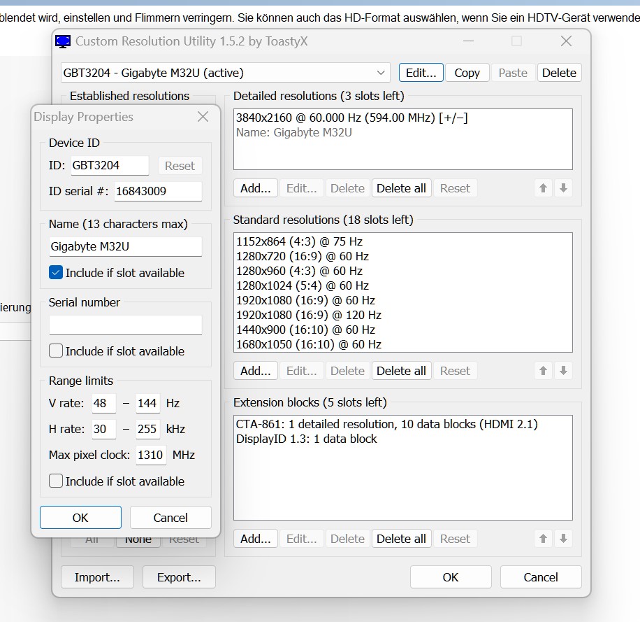

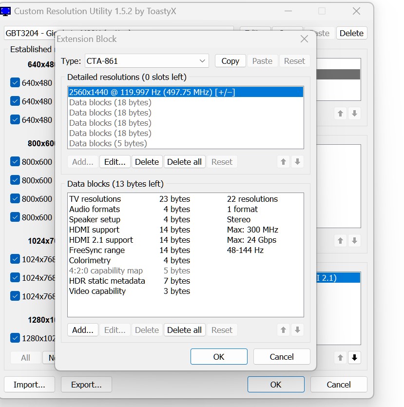

03-27-2023, 04:42 PM (Last edited: 03-27-2023, 05:05 PM by sebastian.f)
Post: #7329
M32U was with DP cable and the TV has only HDMI 2.1
I dont have the M32U anymore but i have make some screenshots from cru before.
4k 144hz 8bit were great for me with DSR. But when iam set this DSR is not showing directly. I can try to restart or using cru reset64.exe.
edit: i have test 100hz, 4.2.0, 8bit but DSR is not showing :-(
