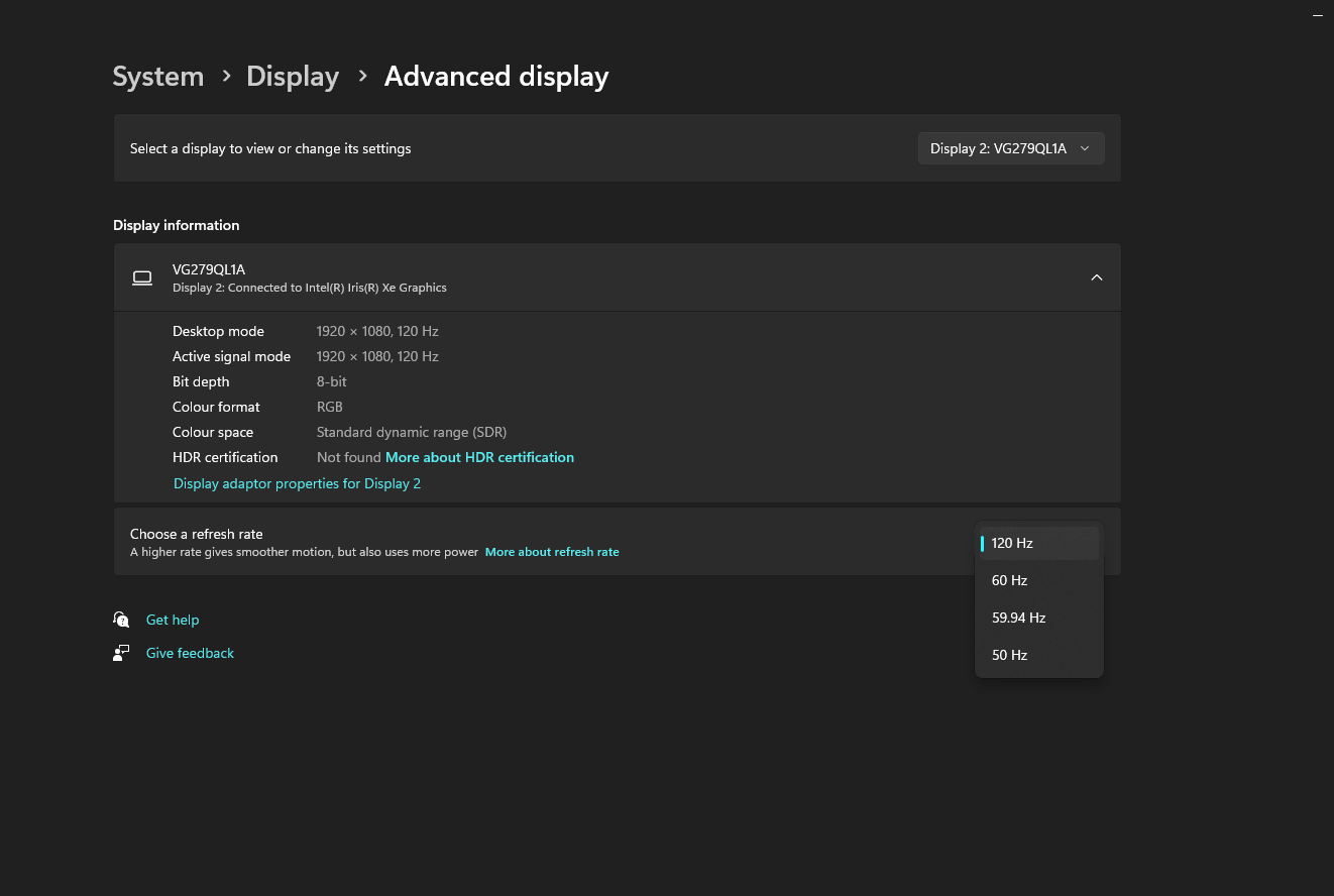

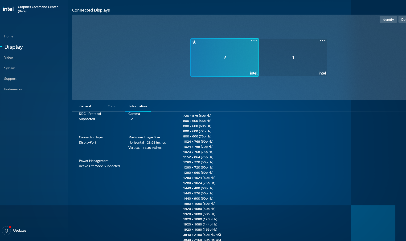

Hi i have an external monitor which can be on 165 refresh rate. I just updated my laptop to windows 11 and suddenly my refresh rate options became limited. I have tried the intel graphic control and using CRU but it didnt change my refresh rate options on windows advanced display setting. I have added the 165hz into cru detailed resolution but it still didnt work. In the intel graphic app the supported resolutionfor 144 and 165 hz is still there. I am primary a fps gamer and so i need all the hz i have. Thanks for the help. attached are the screenshots. Also i cant change my refresh rate from monitor settings. i used to be able to just change it with cru back in windows 10 but now the options are just gone. I would like to also mention i cant add a custom resolution from nvidia since its an intel graphic and the intel graphic app doesnt have the refresh rate option when adding custom resolutions

(06-26-2023 03:54 PM)Kru1cif3r Wrote: Hi i have an external monitor which can be on 165 refresh rate. I just updated my laptop to windows 11 and suddenly my refresh rate options became limited. I have tried the intel graphic control and using CRU but it didnt change my refresh rate options on windows advanced display setting. I have added the 165hz into cru detailed resolution but it still didnt work. In the intel graphic app the supported resolutionfor 144 and 165 hz is still there. I am primary a fps gamer and so i need all the hz i have. Thanks for the help. attached are the screenshots. Also i cant change my refresh rate from monitor settings. i used to be able to just change it with cru back in windows 10 but now the options are just gone. I would like to also mention i cant add a custom resolution from nvidia since its an intel graphic and the intel graphic app doesnt have the refresh rate option when adding custom resolutionsIf your monitor supports 165 Hz, then you shouldn't need to add it. I don't understand why you would use CRU to add a refresh rate that should already exist. Ask Intel why their driver is not allowing 165 Hz. |
