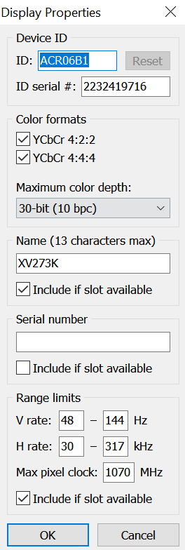

I have another question regarding the pixel clock limit.
In CRU, it says in the Display Properties that the max. pixel clock of my monitor is 1070 MHz.
Do I have to look out for this too?
If I go above 1070 MHz, am I overclocking my monitor?

I've never seen the reported max pixel clock matter, so I wouldn't worry about it. DisplayPort is packet-based and runs at fixed clock speeds, so it's more a matter of whether the monitor can handle the resolution and refresh rate. The blanking mainly affects how long to wait between each line and frame, so it wouldn't visibly affect the image. The driver doesn't seem to report if DSC is active or not, but NVIDIA doesn't support scaling features such as DSR, DLDSR, and image scaling with DSC unless something changed recently, so that might be one clue.
