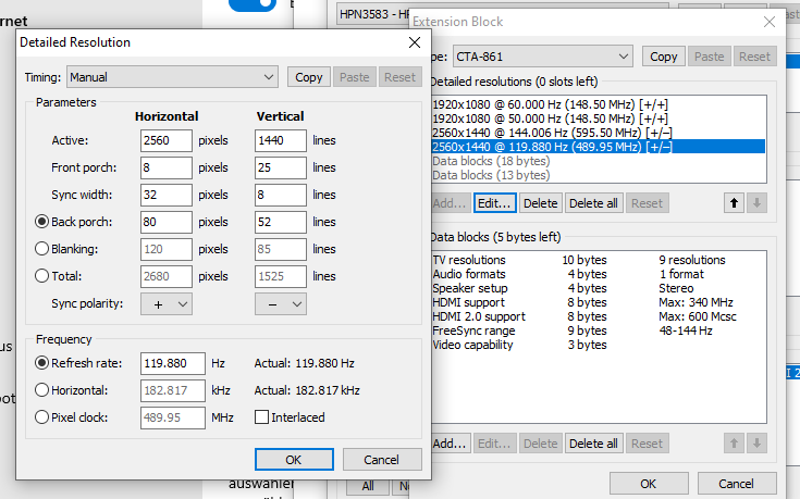

Hi there, as my kids got an xbox series S as christmas present I handed over my "old" HP 27xq monitor to them.
I had two of them running on my gaming PC and they did run with WQHD (2.560 x 1.440) and 120H (connected via HDMI) Little surprise as the XBOX (HDMI as well) doesn't support running 1440dpi and 120Hz (1080dpi works). I learned this is due to HP not sticking to the VESA standard and reporting 119,xxHz instead of 120Hz to the xbox. So i tried changing the EDID information with CUR (changed the 119Hz to 120Hz, removed TV resolutions and added second and flashed the HP firmware with the new bin file. This is what I get when reading the EDID from the monitor after flashing: *** Detailed Timing Descriptors: DTD 1: 2560x1440 59.951 Hz 16:9 88.787 kHz 241.500 MHz (640 mm x 360 mm) Hfront 48 Hsync 32 Hback 80 Hpol P Vfront 3 Vsync 5 Vback 33 Vpol N DTD 2: 2560x1440 120.000 Hz 16:9 177.721 kHz 483.400 MHz (640 mm x 360 mm) Hfront 48 Hsync 32 Hback 80 Hpol P Vfront 3 Vsync 5 Vback 33 Vpol N Dummy Descriptor: Dummy Descriptor: Extension blocks: 1 Checksum: 0x8f ---------------- Block 1, CTA-861 Extension Block: Revision: 3 Basic audio support Supports YCbCr 4:4:4 Supports YCbCr 4:2:2 Native detailed modes: 0 Video Data Block: Audio Data Block: Linear PCM: Max channels: 2 Supported sample rates (kHz): 48 44.1 32 Supported sample sizes (bits): 24 20 16 Speaker Allocation Data Block: FL/FR - Front Left/Right Vendor-Specific Data Block (HDMI), OUI 00-0C-03: Source physical address: 1.0.0.0 Maximum TMDS clock: 340 MHz Vendor-Specific Data Block (HDMI Forum), OUI C4-5D-D8: Version: 1 Maximum TMDS Character Rate: 600 MHz SCDC Present Vendor-Specific Data Block (AMD), OUI 00-00-1A: 01 01 30 90 ed '..0..' Video Capability Data Block: YCbCr quantization: No Data RGB quantization: No Data PT scan behavior: Supports both over- and underscan IT scan behavior: Supports both over- and underscan CE scan behavior: Supports both over- and underscan Detailed Timing Descriptors: DTD 3: 1920x1080 60.000 Hz 16:9 67.500 kHz 148.500 MHz (480 mm x 270 mm) Hfront 88 Hsync 44 Hback 148 Hpol P Vfront 4 Vsync 5 Vback 36 Vpol P DTD 4: 1920x1080 50.000 Hz 16:9 56.250 kHz 148.500 MHz (480 mm x 270 mm) Hfront 528 Hsync 44 Hback 148 Hpol P Vfront 4 Vsync 5 Vback 36 Vpol P DTD 5: 2560x1440 144.006 Hz 16:9 222.201 kHz 595.500 MHz (640 mm x 360 mm) Hfront 8 Hsync 32 Hback 80 Hpol P Vfront 25 Vsync 8 Vback 70 Vpol N DTD 6: 2560x1440 120.000 Hz 16:9 183.000 kHz 490.440 MHz (640 mm x 360 mm) Hfront 8 Hsync 32 Hback 80 Hpol P Vfront 25 Vsync 8 Vback 52 Vpol N '**** But the XBOX still says 1440 /120Hz is not supported by the monitor. What do I miss here? Where is the XBOX getting the information from? |

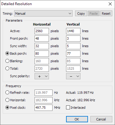

(01-17-2024 06:26 PM)Goddi8 Wrote: Hi there, as my kids got an xbox series S as christmas present I handed over my "old" HP 27xq monitor to them.You have that backwards. I can't find any information about what specific timing the Xbox requires, but assuming VESA CVT-RB, that would be "Automatic PC" or "CVT-RB" with the pixel clock manually rounded down to the nearest 0.25 MHz, so 497.75 MHz, which is around 119.997 Hz. You have 2560x1440 @ 120 Hz in there twice, neither of which match that timing. What are you using to flash the monitor? |

(01-17-2024 07:22 PM)ToastyX Wrote:(01-17-2024 06:26 PM)Goddi8 Wrote: HiYou have that backwards. I can't find any information about what specific timing the Xbox requires, but assuming VESA CVT-RB, that would be "Automatic PC" or "CVT-RB" with the pixel clock manually rounded down to the nearest 0.25 MHz, so 497.75 MHz, which is around 119.997 Hz. You have 2560x1440 @ 120 Hz in there twice, neither of which match that timing. What are you using to flash the monitor? I am using https://github.com/bulletmark/edid-rw on ubuntu to flash the firmware. Changing the values to the one you suggested did the trick. I cannot set HDMI manually and set 1440/120 in the xbox - for what ever reason it still says not supported. I have to use the auto detect feature at the xbox but I can set 1440 and 120Hz now! Awesome tool btw and even better support. These are the default settings from the HP. |
