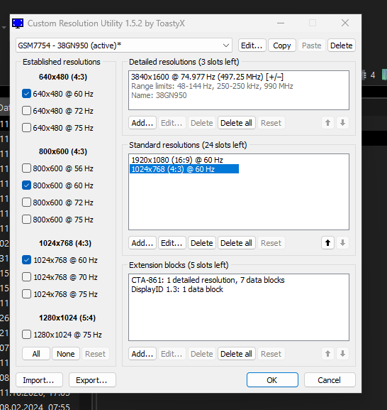

(03-07-2024 04:16 PM)LaPsiuta Wrote:  how? i don't know how to do this
Just delete the refresh rates you don't want.
i edited vrate to 120 and i still have 144 in games and win cp.

(03-08-2024 09:06 AM)LaPsiuta Wrote:  i edited vrate to 120 and i still have 144 in games and win cp.
I didn't say edit the vrate.
Ok so what shoud i do step by step? I don't have avaliable resolutions list.
03-08-2024, 04:17 PM
Post: #8045
(03-08-2024 02:50 PM)LaPsiuta Wrote:  Ok so what shoud i do step by step? I don't have avaliable resolutions list.
Honestly, if you can't figure it out, you shouldn't use this program. It's not that hard. Edit the extension blocks. 144 Hz is probably in the DisplayID extension block.
