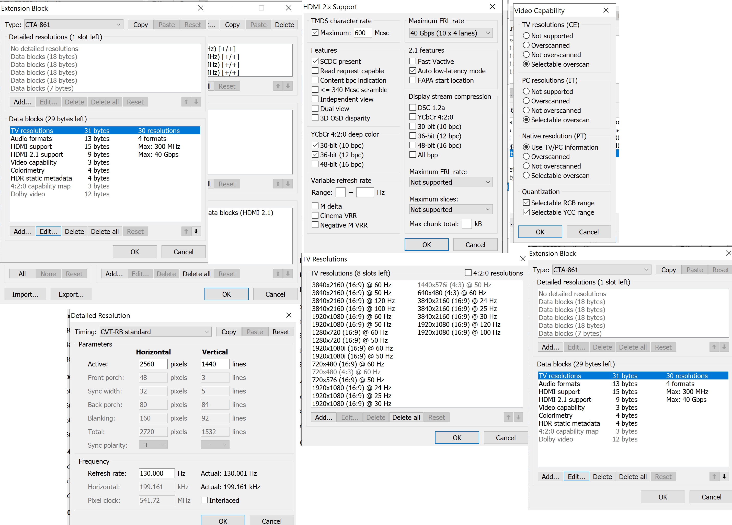

Is it possible to change the refresh rate on the lg c1 at all? I am using a correct cable in port 1 (non earc hdmi 2.1).
I can not change the hz lower or higher at any res so far.
What I am trying to accomplish 1440p at 144hz or more so it will feel atleast as smooth as my 144hz ips screen in fps game.
on a side note, I tried deleting the 4096 resolution but when I restart its back in cru under tv res and hdmi 1.x res
I want to use my c1 as a monitor, center scaled to a lower than 4k res with the highest possible static refresh rate.
I will attach some screenshots and the log file ive see you ask for before.

What happens when you try to change the refresh rate? As far as I know, the only refresh rates the LG C1 supports beyond 60 Hz are 100 and 120 Hz. Other refresh rates might not display correctly if at all. You should be able to use 2560x1440 @ 120 Hz. You should be able to delete 4096x2160. I don't see how they can reappear on their own. The test.txt file shows it was saved like that.
