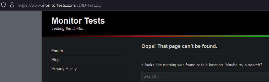

(09-27-2024 12:07 AM)ToastyX Wrote:
(09-26-2024 12:35 AM)funkerwolf Wrote:  It is all in place, but on the latest versions in Windows and through the Intel panel does not give just select 75 hertz, there is no such item to select.
Show me what you have. Run this and post the test.txt here: https://www.monitortests.com/EDID-test.zip
