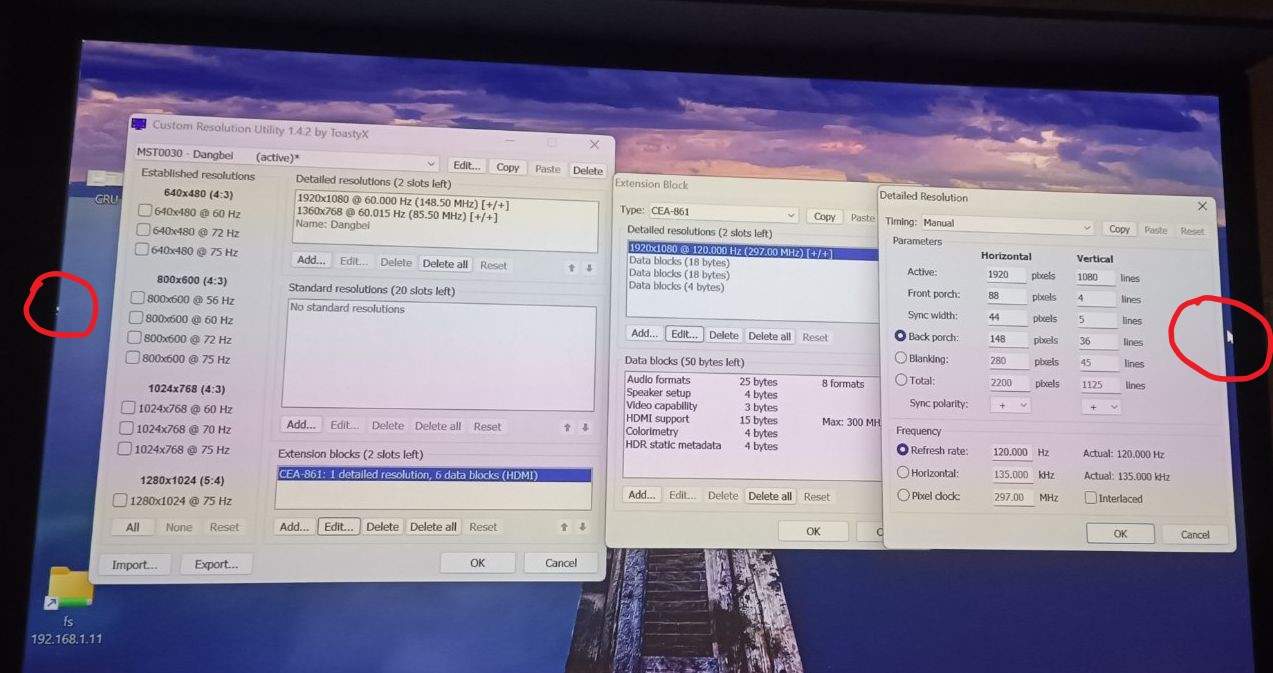

Hello. I have unexpected problem. Im using Dangbei X3 projector, which is fullHD DLP and supports 120hz. When i connected miniPC (Windows 11, intel N100 with intel HD graphics) to it, i could only choose from resolutions with 60hz. Even though projector supports 120hz, there were no resolutions with 120hz to choose from. So i used Custom Resolution Utility and made one 1920x1080 with 120Hz. It's working fine, except for one weird thing - last few rows from right side are visible on the left. As you can see on the photo. I highlighted mouse cursor, right part of it is visible on the left side. When i switch to resolution with 60hz - everything is fine. All the numbers in CRU are default (on the photo), and my 120hz resolution has the same numbers as the default 60hz resolution, except for frequencies. I tried to change the numbers for back porch, front porch and horizontal total back and forth for a small amount, doing restart64 after each iteration, and it didnt change anything at all. Need help! What is causing this and how can i possibly fix that problem?

(10-16-2024 07:58 AM)Polytech Wrote:  Hello. I have unexpected problem. Im using Dangbei X3 projector, which is fullHD DLP and supports 120hz. When i connected miniPC (Windows 11, intel N100 with intel HD graphics) to it, i could only choose from resolutions with 60hz. Even though projector supports 120hz, there were no resolutions with 120hz to choose from. So i used Custom Resolution Utility and made one 1920x1080 with 120Hz. It's working fine, except for one weird thing - last few rows from right side are visible on the left. As you can see on the photo. I highlighted mouse cursor, right part of it is visible on the left side. When i switch to resolution with 60hz - everything is fine. All the numbers in CRU are default (on the photo), and my 120hz resolution has the same numbers as the default 60hz resolution, except for frequencies. I tried to change the numbers for back porch, front porch and horizontal total back and forth for a small amount, doing restart64 after each iteration, and it didnt change anything at all. Need help! What is causing this and how can i possibly fix that problem?
The projector is not displaying 120 Hz correctly. What you have should work. There are no timing parameters that would cause this issue. Are you sure the projector supports 120 Hz? I only see a reference to MEMC, which motion interpolation, not 120 Hz input. Normally you shouldn't have to add 120 Hz manually if it's supported.

(10-16-2024 10:27 AM)ToastyX Wrote:  The projector is not displaying 120 Hz correctly. What you have should work. There are no timing parameters that would cause this issue. Are you sure the projector supports 120 Hz? I only see a reference to MEMC, which motion interpolation, not 120 Hz input. Normally you shouldn't have to add 120 Hz manually if it's supported.
Although there's nothing in official specs about 120hz or any hz at all, I saw some ppl testing it on 120hz for input lag on different forum. It supports 3D, some online shops specify that it supports 120hz.
But i'm certain it outputs 120hz because most DLP projectors can only output frequency of 60hz (the newer ones - frequencies divisible by 60 - 60,120,240). When you watch a movie, most of the time it has 23.976 fps and outputting it to the projector with 60hz you can clearly see the mismatch in fps/hz. Image has microstutters because some frames are repeated 2 times, and some of them 3 times. 120hz is divisible by 23.976 almost perfectly and the image is SMOOOOTH. Which i clearly see. That was the reason to buy and connect miniPC to the projector.

(10-16-2024 11:05 AM)Polytech Wrote:  Although there's nothing in official specs about 120hz or any hz at all, I saw some ppl testing it on 120hz for input lag on different forum. It supports 3D, some online shops specify that it supports 120hz.
All I can suggest is try RGB vs. YCbCr 4:4:4 in the Intel graphics settings, and if that doesn't help, try CVT-RB timing. Beyond that, this is an issue with the projector's firmware not handling the resolution correctly, so maybe a slightly lower resolution would help.
