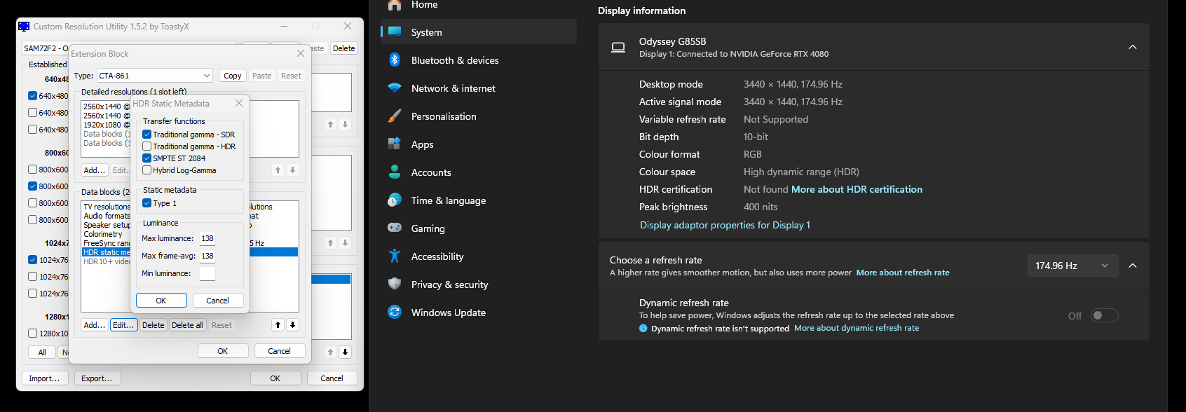

(10-22-2024 12:02 PM)Audioboxer Wrote: Hi guys just signing up to say I've noticed Windows now reporting 400 instead of 1000 like it was previously. Been using CRU since I got my G8 and it's been fine changing peak brightness, but doesn't seem to be working now.Well either NVIDIA's driver is ignoring the change or there's something else overriding it. What happens if you delete the HDR10+ data block? Have you tried the Windows HDR Calibration app? |

(10-24-2024 05:24 PM)ToastyX Wrote:(10-22-2024 12:02 PM)Audioboxer Wrote: Hi guys just signing up to say I've noticed Windows now reporting 400 instead of 1000 like it was previously. Been using CRU since I got my G8 and it's been fine changing peak brightness, but doesn't seem to be working now.Well either NVIDIA's driver is ignoring the change or there's something else overriding it. What happens if you delete the HDR10+ data block? Have you tried the Windows HDR Calibration app? Windows calibration app responds fine with the scaling on white going up to 993 nits before image completely disappears. I don't tend to save a profile with it though, just check nothing is being cut off incorrectly. I know if you save a profile it can make peak brightness display correctly under Advance display, but CRU always skipped that step being needed. I'll try deleting the HDR10+ data block. |
