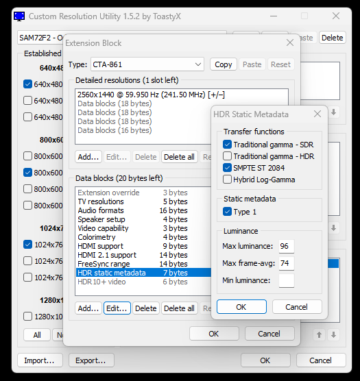

ToastyX, here is what could be a noobish question for you.
I've just switched from DP to HDMI on my Samsung G8 because I finally picked up a HDMI 2.1 cable. I also wanted to see if I could reproduce the current behaviour I have where editing the monitor max luminance didn't seem to be changing in Windows system settings anymore.
New issue though, if I edit this
It actually bricks me getting into Windows. As soon as login screen should appear the monitor just goes black/no signal and begins its 60 second timeout timer.
Spent the last few hours tearing my hair out thinking the HDMI cable was faulty/reinstalling drivers after cleaning in safe mode and finally figured out it was simply any time I edited max luminance it would brick the monitor from displaying anything once Windows loaded (after a restart from editing).
Maybe this is me not understanding editing under HDMI is different from DP, or is it something else???
Cheers
11-11-2024, 08:17 PM
Post: #8590
(11-10-2024 06:02 PM)Audioboxer Wrote:  It actually bricks me getting into Windows. As soon as login screen should appear the monitor just goes black/no signal and begins its 60 second timeout timer.
Is the computer frozen (does caps lock respond)? Do you have any other monitors connected?
