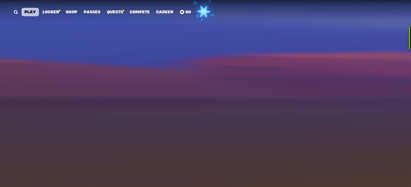

(01-04-2025 05:25 AM)ToastyX Wrote:Ah yes i see that now, but then how do you paste it into the top box under detailed resolutions? when i paste it into the detailed resolutions at the top like id normally do its in red, i tried deleting the top detailed resolutions and the middle box and just keeping the displayid and changing it to my specific resolution and i thought it worked at first but it changed it to gpu scaling and my fortnite game looked like this..(01-04-2025 01:23 AM)wheo9x Wrote: The method to get a custom stretch res on 240hz when you go to detailed resolutions at the bottom you can only use the options there? the highest it shows is 240hz not 360hz when im using a 360hz monitor, there is no 360hz option and when i try to edit it at the bottom the number goes to red and i can't apply it.The first post explains why the number turns red. 1920x1080 @ 360 Hz should already be there in a DisplayID extension block. Is there any chance you could list exactly how you do it from start to finish please? or some type of youtube video or something? |

(01-04-2025 09:56 PM)wheo9x Wrote: Ah yes i see that now, but then how do you paste it into the top box under detailed resolutions? when i paste it into the detailed resolutions at the top like id normally do its in red, i tried deleting the top detailed resolutions and the middle box and just keeping the displayid and changing it to my specific resolution and i thought it worked at first but it changed it to gpu scaling and my fortnite game looked like this..How to do what exactly? I don't understand why every time someone says "stretched resolution" they are always so vague. I can't give exact instructions if you won't tell me exactly what you're trying to do. Why do you need to paste it into the top box? What exactly are you trying to do? Saying "stretched resolution" doesn't tell me anything. I already told you, CRU doesn't deal with scaling. You set the resolution you want, and then the monitor scales the resolution if you're using display scaling, or the GPU scales it to the native resolution if you're using GPU scaling. If that doesn't answer your question, then you're not telling me the actual problem. All CRU can do is control which resolutions are sent to the display and which resolution Windows considers to be the native resolution. Any resolution listed in CRU should be sent to the display if you're using display scaling. The first detailed resolution is considered the native resolution. If you want to change what Windows considers to be the native resolution, the refresh rate part doesn't matter, so if you can't set it to 360 Hz, then just set it to 60 Hz, and add 360 Hz separately in a DisplayID extension block. |
