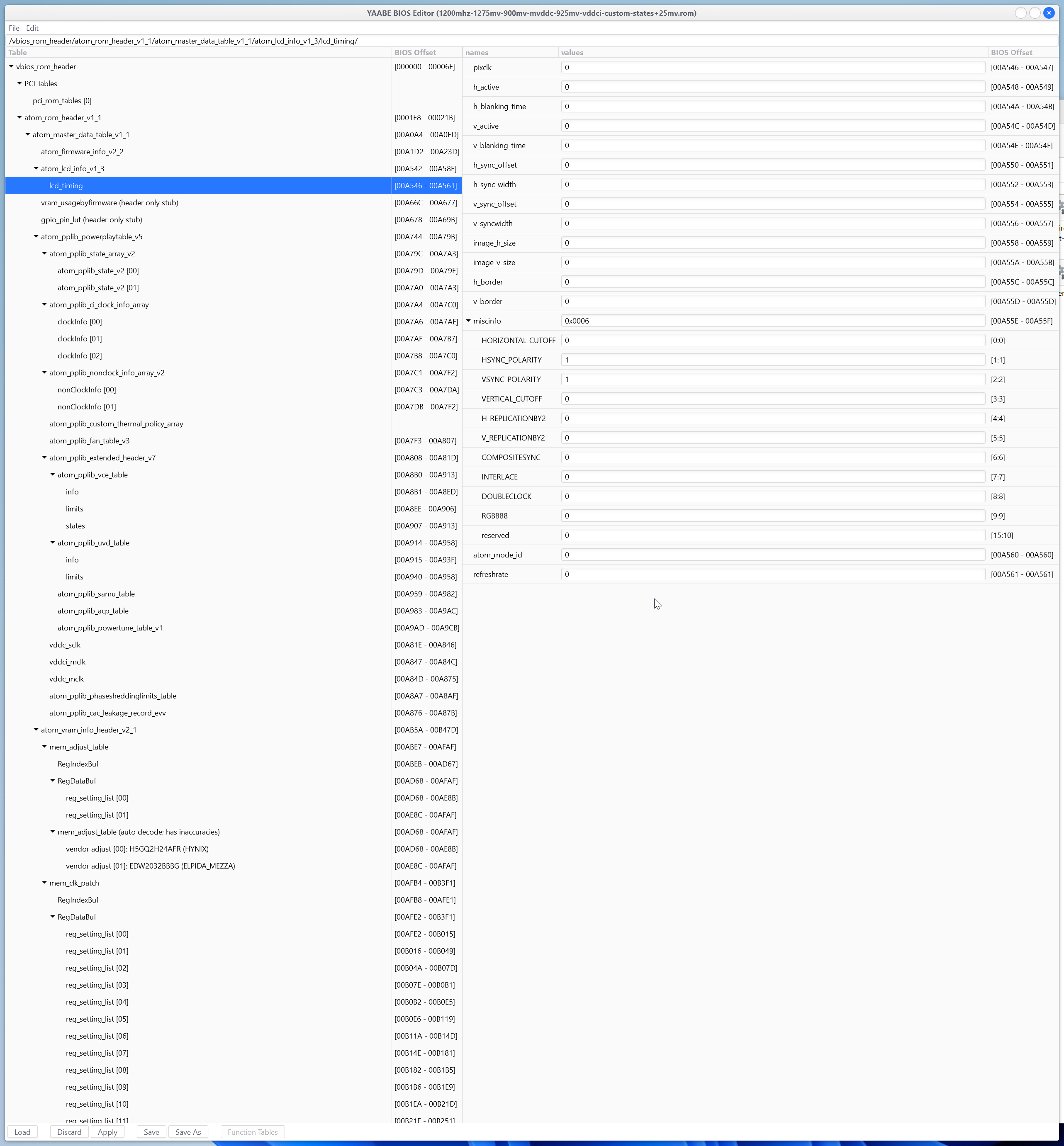

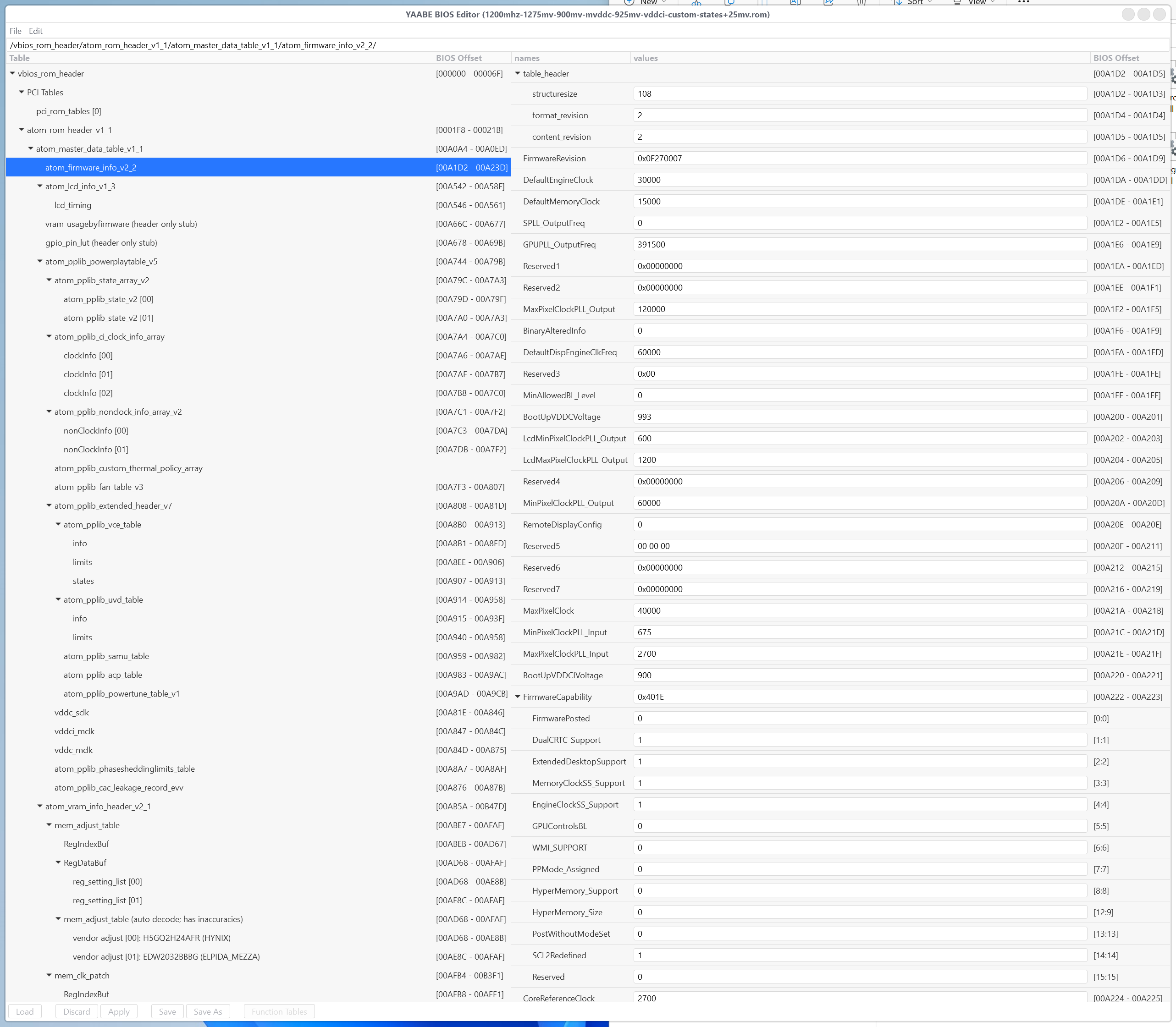

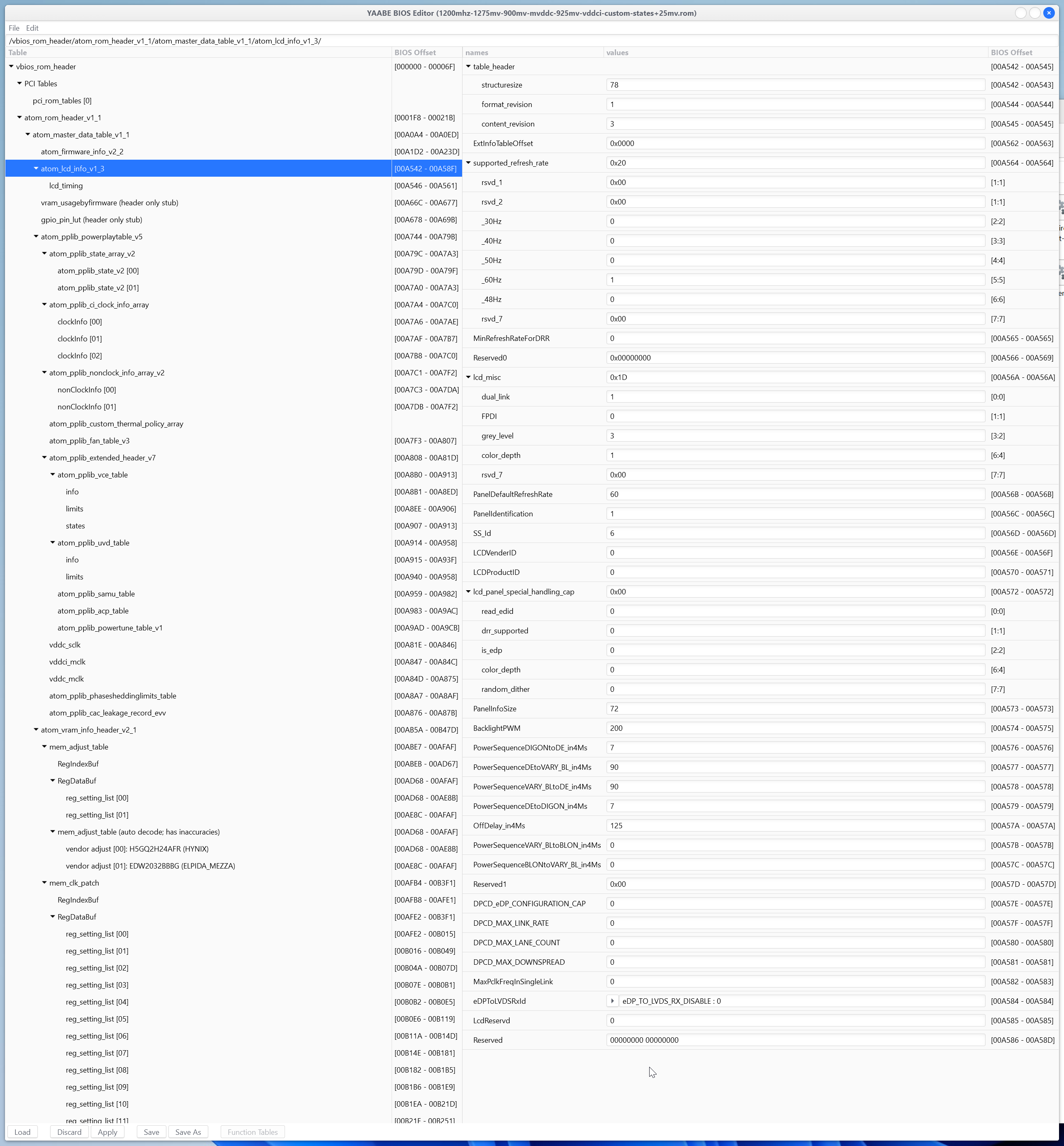

Allow me to rephrase. Okay so I bought a 4k60 displayport display, only 8bpc still showing up in radeon settings, max 4k30hz on r9 290 just like hdmi.
How do I set 6bpc in the registry for my new displayport, display?
On a side note about "HDMI 1.4a", how do I get more than 300mhz if i use the patcher and set 340mhz, still nothing more than 300mhz. Which configuration & driver is recommended for 340mhz hdmi operation if my displayport display isn't going to work out?
I have the knowledge of how to edit the video bios pixel clock, which would it be?
Thanks

What model is the display? What is the exact GPU you have? The R9 290 should support DisplayPort 1.2 up to 600 MHz pixel clock, which is enough for 3840x2160 @ 60 Hz at 8 bpc with 4:4:4 chroma, so either you don't have an R9 290, or something is not working correctly because this should work out of the box. You shouldn't need to set 6 bpc, and the option should be available if your GPU supports it.
(03-08-2025 11:12 PM)chris89 Wrote:  On a side note about "HDMI 1.4a", how do I get more than 300mhz if i use the patcher and set 340mhz, still nothing more than 300mhz. Which configuration & driver is recommended for 340mhz hdmi operation if my displayport display isn't going to work out?
The R9 290 never supported more than 297 MHz pixel clock with HDMI. The patcher will allow you to go up to 400 MHz, but the signal might not be stable or usable at all. I don't see a reason to use HDMI with your GPU if the display has DisplayPort because even DisplayPort 1.0 supports up to 360 MHz pixel clock with 8 bpc and 480 MHz pixel clock with 6 bpc, which is better than HDMI 1.4. The only exception is 3840x2160 @ 60 Hz with YCbCr 4:2:0, which should automatically work with HDMI if your GPU supported it.
(03-08-2025 11:12 PM)chris89 Wrote:  I have the knowledge of how to edit the video bios pixel clock, which would it be?
The pixel clock limit is usually in the driver. You shouldn't need to mess with the video BIOS for this to work.
